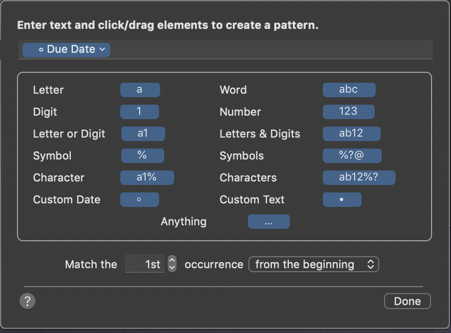

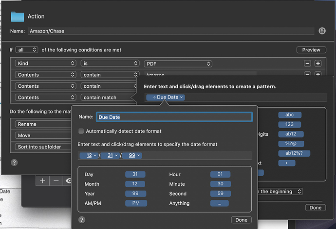

and my Hazel rule looks like this:
I have the Synchrony Amazon card and it looks a little different. I have rules for it set up almost identical to yours, but the date I need is the second occurrence. But it won’t grab the second for some reason. It will grab the 1st, 3rd, 4th, etc but not the second. :thinking:

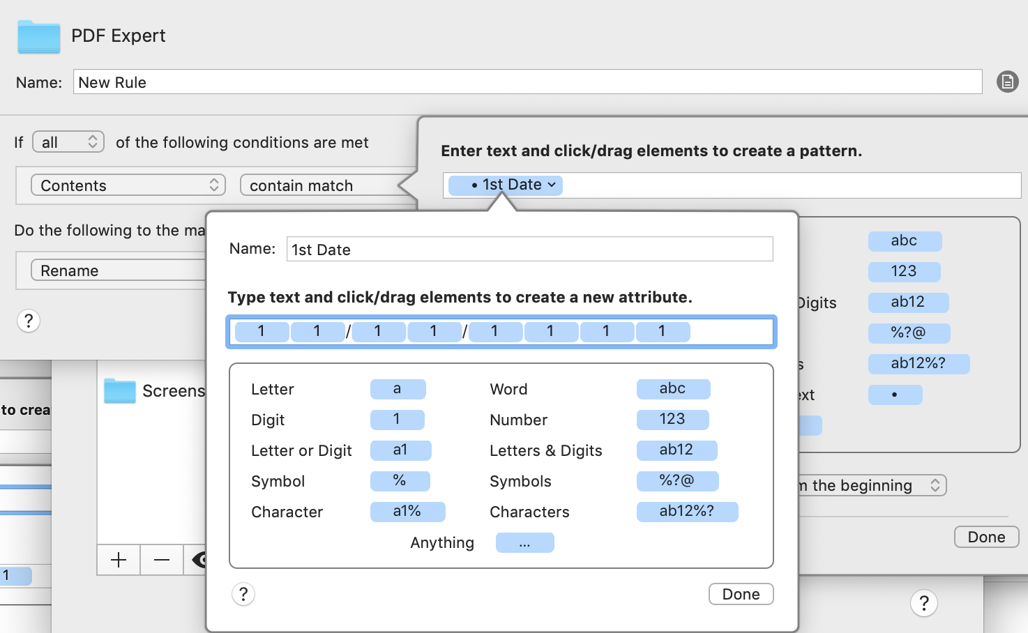

Try using a Custom Text match. Even better if there are regular characters preceding or succeeding the date you want include them as well, then use the Replace Text function to remove the additional characters when renaming the file.
I was able to get it working with this. I don’t know why the date matching in Hazel can’t find this date. I’m assuming Hazel uses regular expressions to match dates, so I have no idea.
