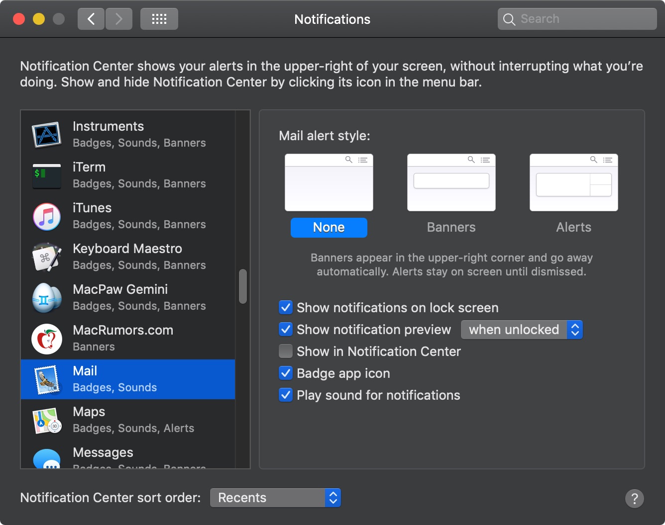

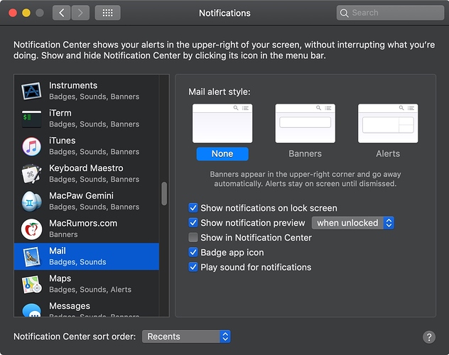

Notifications -> badges (yes) -> banners (no)
This works for my email…
Trying that out now. (Banners was on). Thanks!

JKoopmans suggestion worked for me. And, yes, the issue was the app itself popping up. But it isn’t doing it any more. I do get the badge and the beep, but those are fine (and desired).
