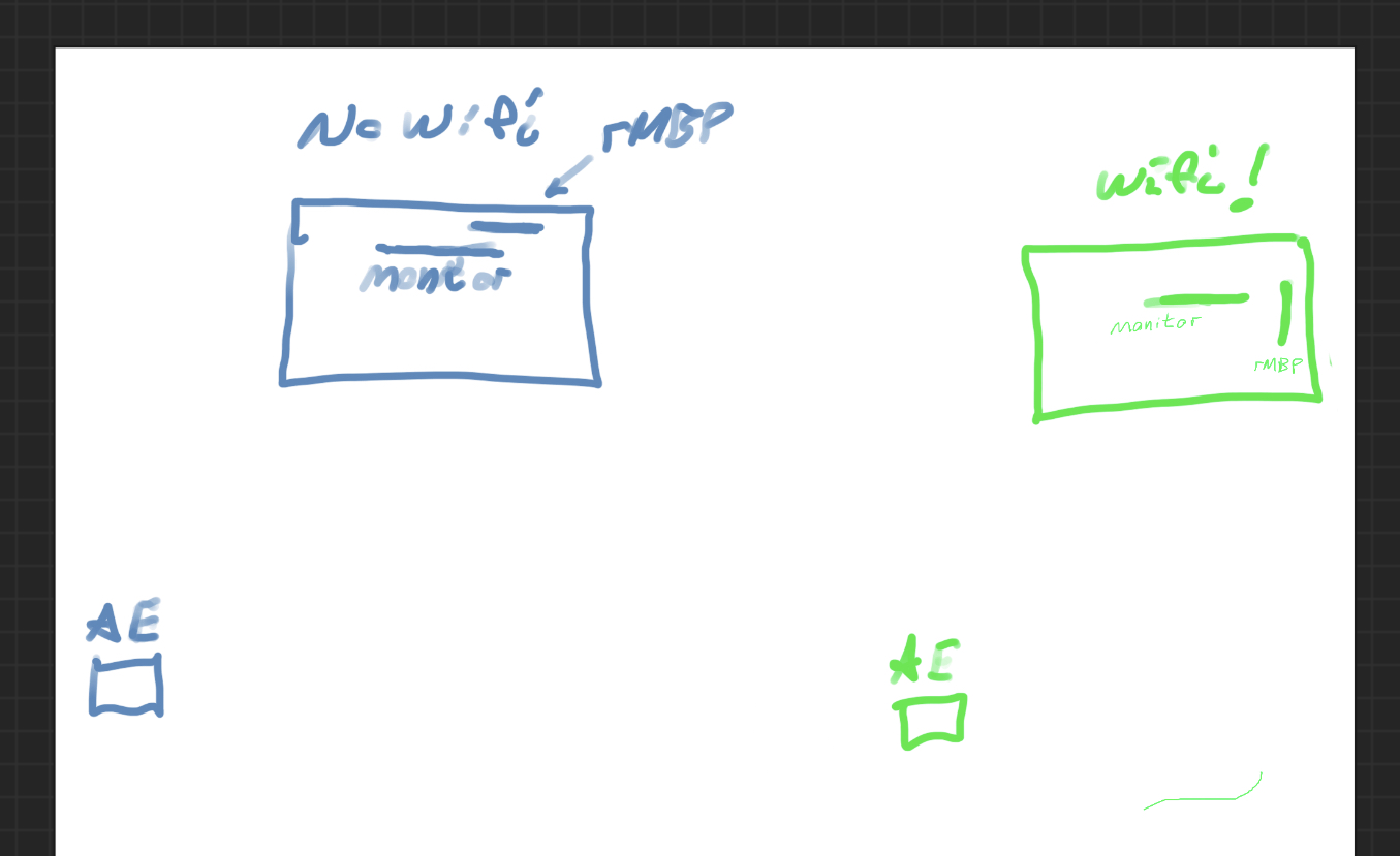

I used to use my 2015 15” rMBP with an external monitor. If the monitor was somewhat between the laptop and my Airport Express (just 6’ 2m away), the WiFi didn’t work well. Reorienting the laptop so that the monitor was not between fixed the issue. In the end, I wound up moving it to the left side of the monitor.
My hypothesis is that the monitor generated or somehow blocked the 2.5GHz signal that WiFi uses. I never tried the 5GHz band.
