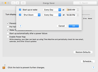

Right now, with the default Power manager, you can only schedule 2 date and time ranges.

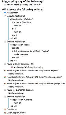

I bought Power Manager but Iâm funding my computer is going to sleep a few seconds later. Can some please explain why? The Keyboard Maestro macro should have triggered caffeine.
Iâd have to see your macro to try to help more, I think.
What I find strange is that with your power settings your computer would not actually sleep. Iâm running just about the same settings and all my cron KM macros work perfectly.

I had a similar problem. I found that going into System Preferences > Energy Saver and adjusting the check boxes you find there helped, do both battery and power adapter tabs. I canât now remember which ones I changed from default. There is one, that I donât fully understand, about âpower napâ, try that one. Try the option that stops you computer sleeping when the display is off too.
I think caffeine just works via the energy saver anyway or takes over its function in some way? I think you should adjust the settings on energy saver in preferences. You could avoid caffeine altogether by just setting the âturn offâ display slider in Energy Saver to âneverâ, which effectively is what Caffeine does? But you want your display off I guess? That is the point of this really for you? Just try the power nap and donât sleep computer when display is off options.
