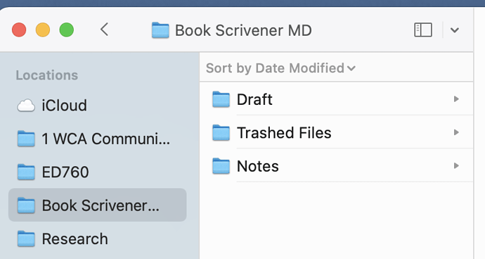

Here are screenshots of how I have this setup. I thought screenshots would be more helpful than a lengthy explanation. NOTE: I have one folder for the book project. That single folder is accessed in Scrivener, Obsidian, and iA Writer.

THE BOOK FOLDER IN FINDER

Once you’ve synced for the first time (using the above settings) you’ll find that your new External Folder has two subfolders: documents in your Binder Drafts/Manuscript group will be in, well, ‘Drafts’, and any other text files in ‘Notes’. If you delete files, they’ll also be a Trashed Files folder.
Note how the file names are (optionally) numbered — these don’t appear back in Scrivener, and they’ll be changed if you rearrange the Binder order after you’ve synced.
