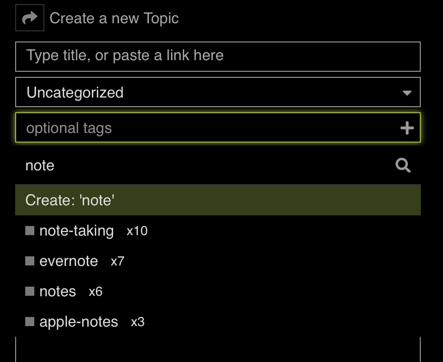

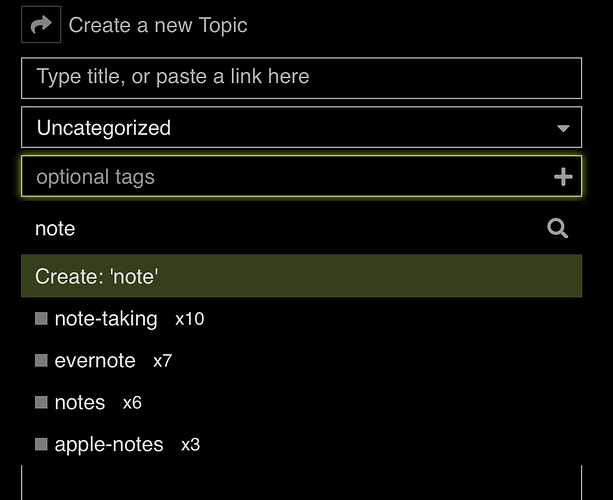

The tagging system here on Discourse is a good example. You can begin typing a tag, and partial matches are listed. You also have the opportunity to create a new tag at the same place.
Admittedly, I don’t know the nuances or scope (number of drugs) of the issue, and this might be impractical.
