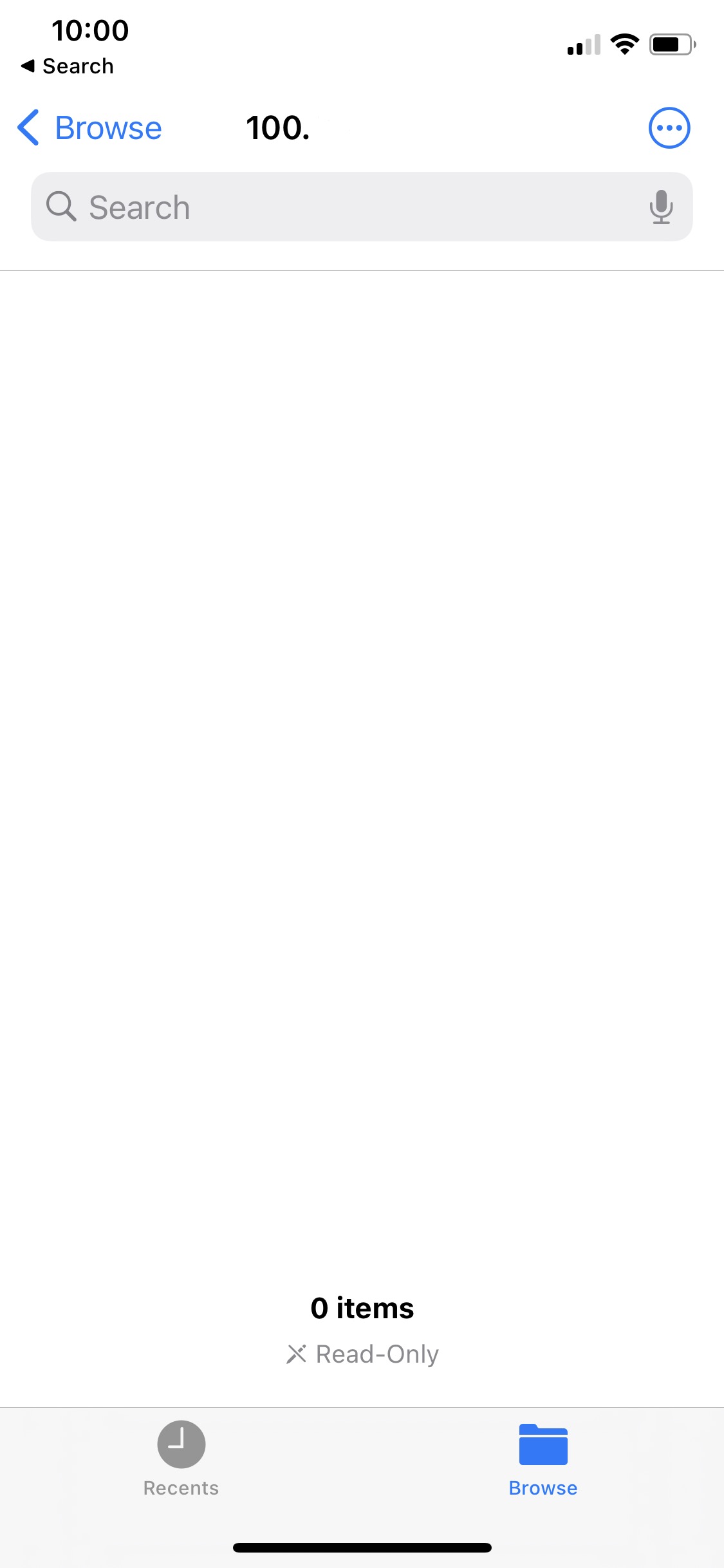

What works for me (using just the Tailscale IP):
Everything seems similar.
The image confirms the question around using https and the https toggle (which is how it has been)…
I have iOS Files > Shared Location > Synology IP connected and showing as you have above (to 5006.)
BUT, selecting that location brings up a an empty page showing - items, Read-Only.
Drive screen looks a bit different…
