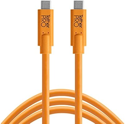

These have worked beautifully for me. I have 2. Connecting iMac Pro to 2 separate external graphics boxes. There’s a chance they throttle down. Hasn’t been an issue though, as one EGPU box contains graphics card, the other ProTools HDX card.
Thanks for sharing! It’s in my shopping card.
USB-C cables are easy to find, it’s the Thunderbolt that are elusive.
