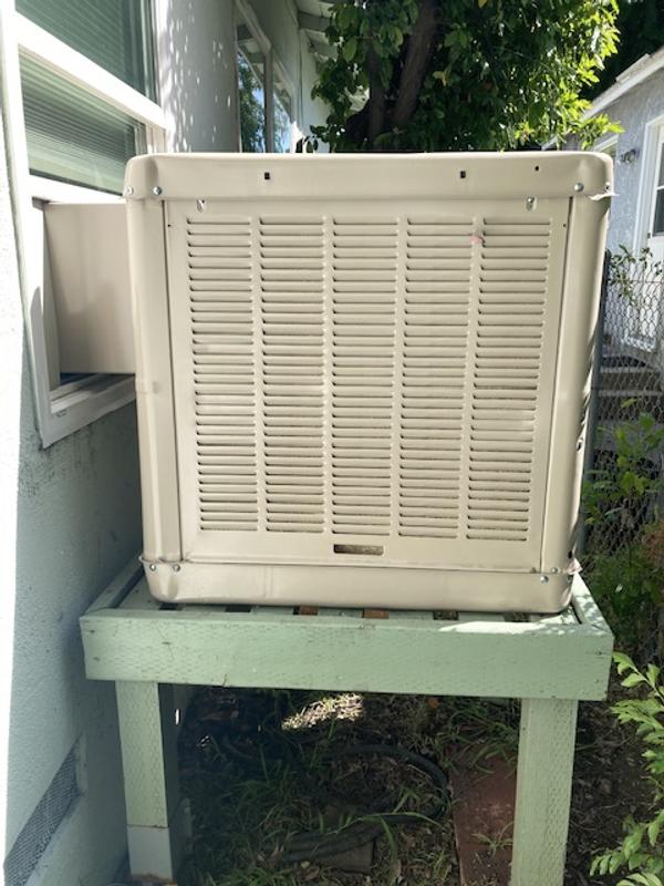

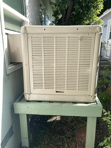

I remember swamp (evaporative) coolers—we used them when we were stationed in the Philippines. It looked very much like this one:
Although they’re more effective in arid climates (setting aside water usage concerns), they do a good job of lowering the overall temperature. If you want to go down a rabbit hole, this study from the International Research Journal of Advanced Engineering and Science is interesting.
New ones are very water efficient. Water use is a critical issue for us too.
PS The water usage about a gallon per hour of operation.

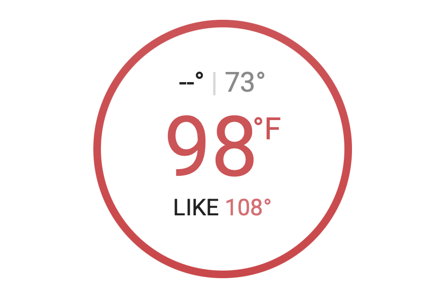

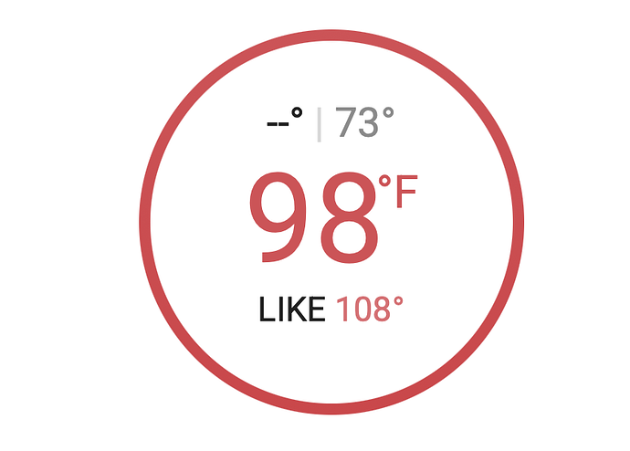

This is coastal Maine. Not that long ago, it was remarkable to have temperatures in the 90s in August. This was today:
The air conditioning was huge; my mother was comfortable and able to cope with excessive heat and humidity.
Glad your mother was comfortable! This is very close to what our temperature was today too. I went for a walk in the heat of it, just to get some fresh air after being cooped up for a couple days during this heat wave, and thought my skin was going to melt off my body.
