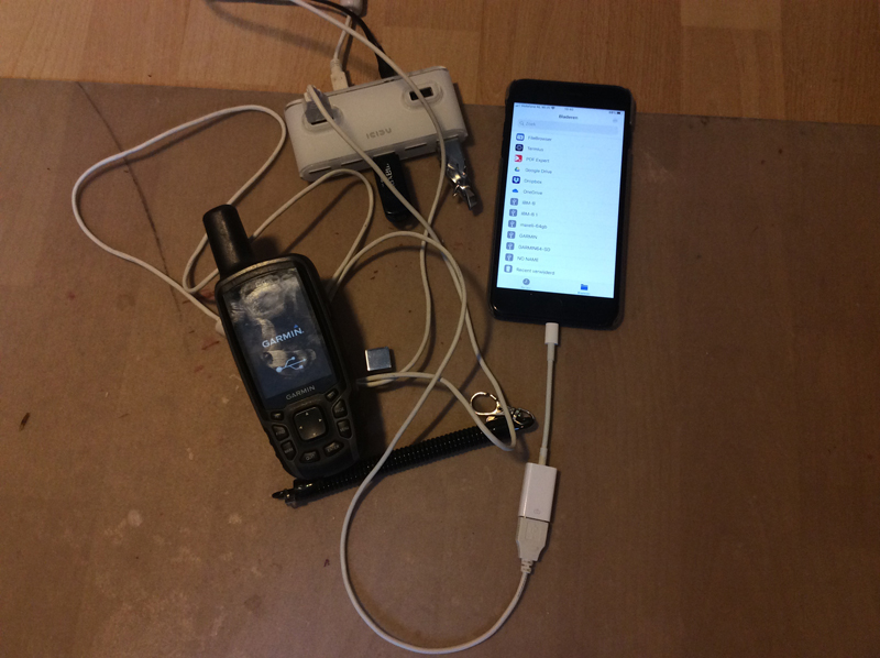

You can also use a non-powered Lightning adapter, but then you need a powered USB hub to power the disks or USB-sticks. In this example a Garmin GPS and two USB-sticks are attached to an iPhone.
On a GPS forum this was a test someone did. I have both the powered and non-powered USB to Lightning adapters. With the non-powered adapter I can only attach SD cards and with the powered adapter my GPS, but also USB-sticks and a Samsung T5 SSD. I was not able to get spinning USB drives to work, maybe it is possible with a powered USB hub.
