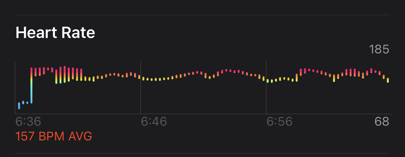

I wanted to run a comparison of the heart rate results between the watch and my chest strap, before I saw your post. I haven’t done that yet, but my own heart rate graph from the watch’s heart-rate sensor looks accurate and shows the types of variations that I would expect. I’ll do an official test in the next day or so and post anything interesting.
I ran my test this morning. I did one 3 mile run trying to achieve a range of heart rates. So, I ran some hill repeats. I set myself up with an Apple Fitness run using the watch’s HR monitor and on my iPhone I ran Polar Beat connected to the chest strap. It’s hard to compare the charts perfectly, but the general trend line seems the same. Plus, they both recorded the same highest heart rate of 181 bpm and the same average heart rate of 157. On balance, it seems like the watch is reporting accurate data for me… or at least I should say I’m getting consistent results between the two different HRMs to which I have access.
One last qualifier. The Apple Watch run started shortly after I started the Polar run. So they are little out of sync for maybe 0.05 mi.
Polar HRM Results
Apple Watch HRM Results
