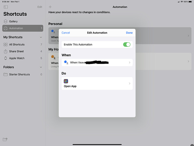

You can have it launch on your iPhone via a location based automation like so:

As in @ChrisEdwards reply, if you use the Open App Shortcut action and then tap on the blue box, you can select any app on your device. Running the Shortcut will open the app to its default screen.
The Shortcut will not run automatically as location based Shortcuts give a tappable notification to confirm and run the Shortcut and also trying to open the app with the screen locked would not work anyway.
ExpressVPN does not appear in the list of apps available to Shortcuts as it does not interact with Shortcuts, however the Open App command can open any app (or I have not found one that it can’t!).

@Tony @ChrisEdwards Now I see! I was not using the scripting option. I believe I now have it setup to launch. I’ll know tomorrow once I leave home for the office. Thanks!
