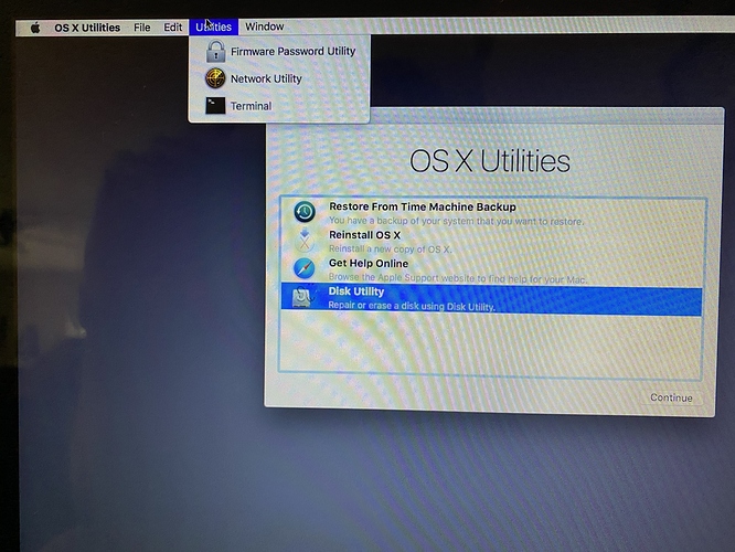

Which operating system are you on? Look at the middle of the second paragraph.
Seems to me that Startup Security Utility is for High Sierra later.
10.11.6 El Capitan
At one point (April post above) I was able to get Startup Security Utility to come up on this machine, but I can’t now.
Oh wow, that corrupted T2 firmware seems horrible. I have a brand new 2020 13” and I will make sure to turn off secure boot. What I’m wanting to do with this old machine is to run Mohave on it via an external drive. I wonder if I could do this if I wipe the machine and start over. There isn’t any data on it that I care about. All my data is on the external drive. I just need this machine for a handful of old files I need to edit that will not run on Catalina. @bowline does this change anything?
If Startup Security Utility has Secure Boot set with Disallow Booting From External Media then you shouldn’t be able to run Mojave or any OS from an external drive.
If you have a bootable external drive somewhere (maybe a backup clone) then try it. But if the machine is locked down and you cannot access Startup Security Utility you may need to contact Apple Support.
Kinda’ important to state at the very beginning! :face_with_raised_eyebrow:
Since you have El Capitan, when starting up using command-R, this is the menu you should see:
