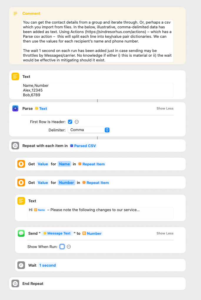

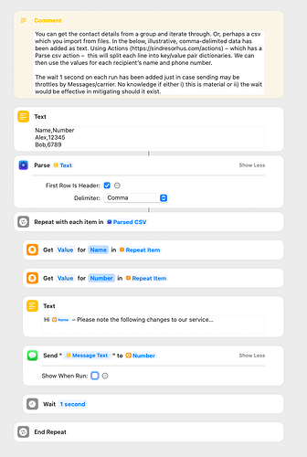

As per @geoffaire, pretty easy to do with Shortcuts. May have to do in batches perhaps to avoid spam flagging (??), but a repeat with each loop in a shortcut would be able to handle. Could even personalise the message with each recipient’s name.
Here’s the kind of shortcut I was thinking of. Again, no real knowledge if looping through 140 recipients would hit a spam flag by either Messages and/or carrier. Nonetheless, the actual mechanics should work…

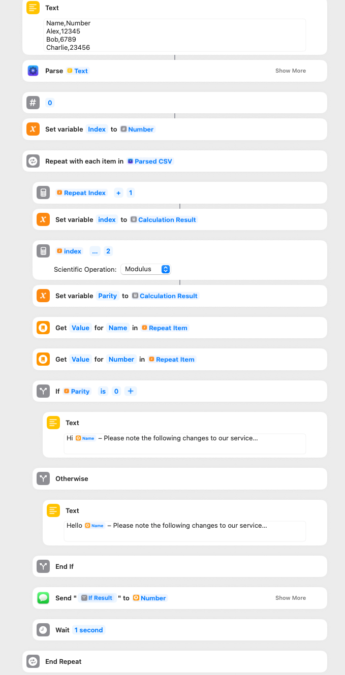

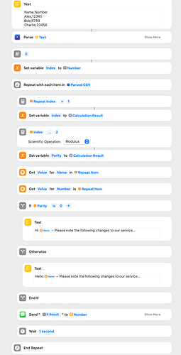

And if you wanted to include further attempts at mitigating spam by varying the content, you could change the salutation based upon whether it’s an odd or even number in the sending run. So, “Hi,” alternates with “Hello,” as per this flow…
