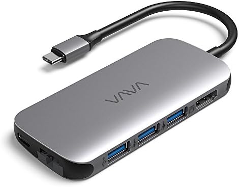

I looked at a bunch of docking stations and tried a few. In the end, I liked this low cost solution the best:
VAVA USB C Hub 8-in-1 Adapter with PD Power Delivery, 4K USB C to HDMI, 3 USB 3.0 Ports, 1Gbps Ethernet Port, SD/TF Cards Reader for MacBook/Pro/Air(2018) and Type C Windows Laptops
Does everything I need. Just one plug and I have my HDMI, Network and power and the capability to plug in a few standard USB-A. At work I don’t have any high speed external devices so I also included a USB-C extension cable so I could hide the dock.
The VAVA USB-C hub is excellent, I bought one as a tester and ended up buying 2 more (home office and for mobile use), after I heard @RosemaryOrchard mention it in one of the MPU podcasts.
A welcome surprise was that display mirroring works with the iPad Pro 12.9 (USC-C model).
It will not charge devices connected to the USB-A ports, at least with my devices it didn’t work. It has a tendency to get a little hot but appears that it is in the design specs for it to get hot.
Gives the same bang for the buck compares to devices that are approximately twice as costly.
I’d say get this USB extension cable, it’s helpful if you have your MBP on a Stan’s, as the connection from the USB-C hub to the MBP is quite short.

It charges mine, may be the amount of power you supply it. In my case 65 watts
I use the Apple standard 61W adapter. It doesn’t work with me unfortunately. It may be specific to my set up.
