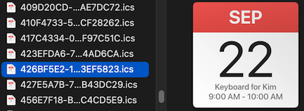

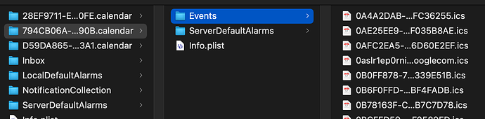

For some reason I was thinking 50K was also the limit on Calendar.app. In any event, until you solve this problem, if you need to search for older entries here’s one really crude way to do it.
Create an export (File/Export/Calendar Archive) of your calendar data. Once this is done remove the .icbu extension from the archive and you will be left with a standard folder containing one subfolder for each calendar.
An Events subfolder, under each calendar, contains individual .ics files for each event. The desired event be searched for using Spotlight and read with Preview by pressing the Spacebar. The total number of events can be seen in the Status Bar, if you have it visible.
events
The .ics file can be opened by Bbedit or your text editor of choice to view full details.
Screen Shot 2021-01-02 at 4.11.18 PM
