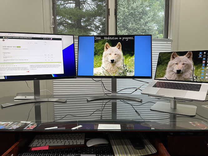

I have a new MBP, and don’t like using 2 of the 3 USB-C ports to connect to my 2 large LG displays. Have been looking for some kind of a docking station that works and having difficulties finding something that works, preferably reasonably priced. Open to any suggestions. Also is it possible to daisy chain the two displays together? The first apple support person said yes, but it didn’t work with HDMI cables.

I appreciate all the responses. Unfortunately, due to the high cost I decided to connect one screen with HMMI and the other through USB-C. I think this will work for now. Someone (non-MPU) had also suggested the WAVLINK USB 3.0 Universal Laptop Docking Station, USB C to 5K/Dual 4K@60Hz Dual Monitor for Windows and Mac… which is available for $ 165.96 at Amazon. That’s a bit less than other options.
Am posting a picture
