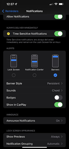

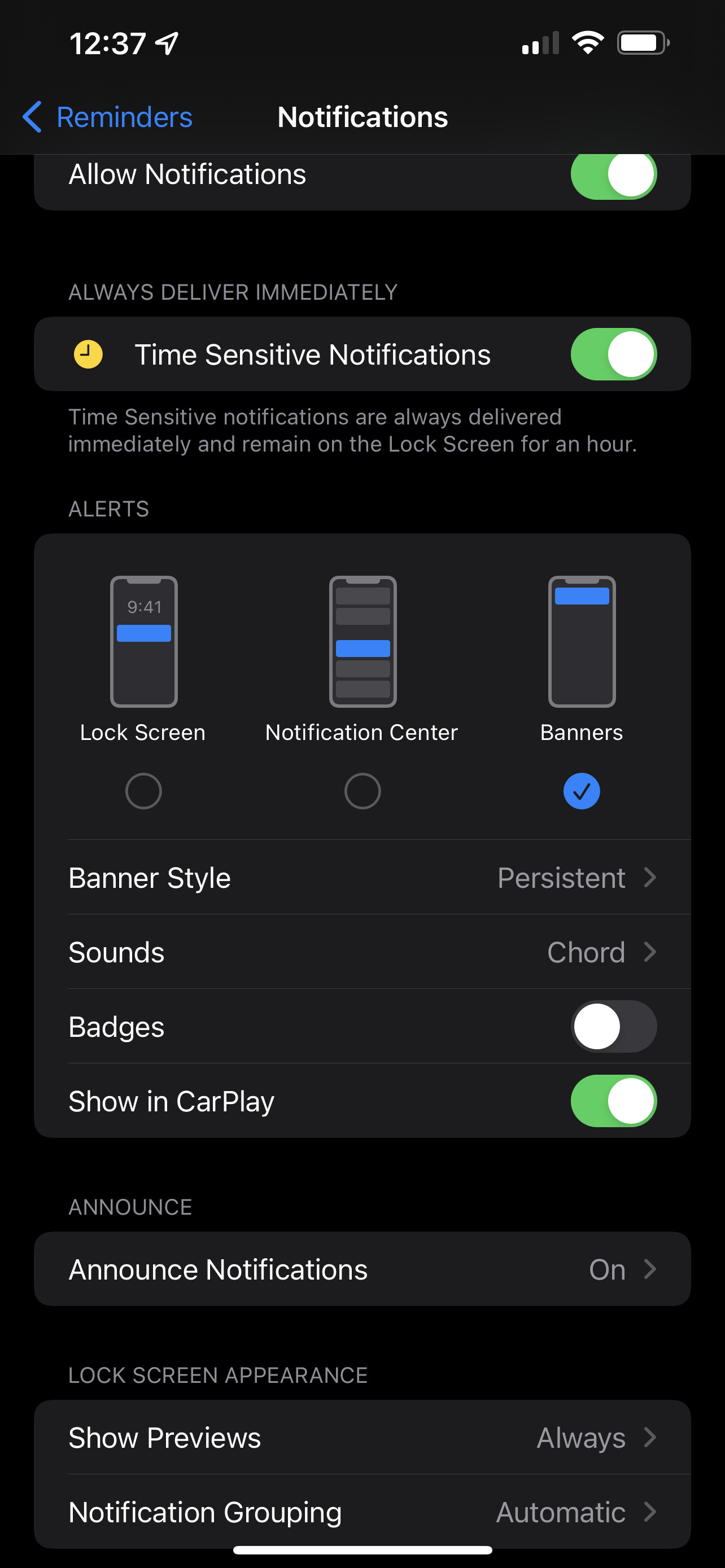

Location reminders is not activating in Car Play. It is working on my iPhone and Apple Watch but not in Car Play. Any ideas as to why? I have the latest iPhone and iOS.
@Bmosbacker : Some (all?) apps have a “Show in CarPlay” option for notifications. Look in Settings > Reminders > Notifications to make sure “Show in CarPlay” is still turned on. That said, I’m not sure how location-based reminders are supposed to behave with CarPlay, so this is just something to double-check and may not help at all!
@margaretamartin Thanks for the tip. I checked it out and everything looks right but I deselected and reselected to see if that reset it properly. Thanks again!
