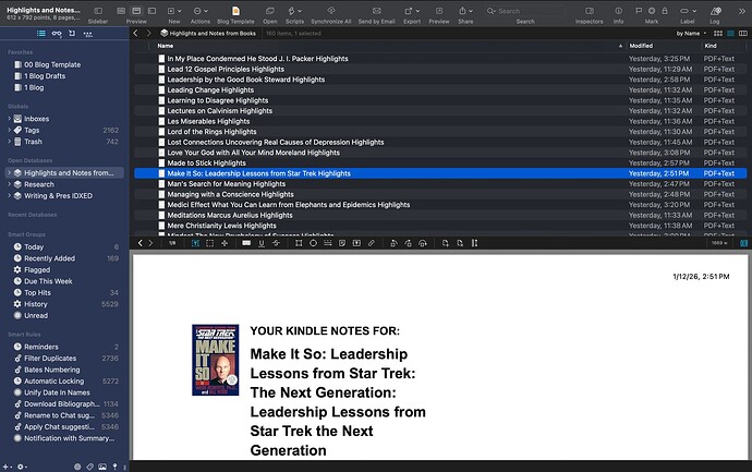

Over several hours, I downloaded all of the highlights and notes from my Kindle library into DEVONthink as OCRed PDFs. I now maintain three databases:
  • All highlights and notes from my digital books
  • All other research materials: PDFs, webpages, excerpts, and related documents
  • An index of all prior writing and presentations
My task now is to classify and cross-link this material by topic. This will be an incremental and lengthy process. I suspect DEVONthink’s classifying function or its AI agent could assist with this work, but I have not yet determined how to connect my AI accounts to DT.

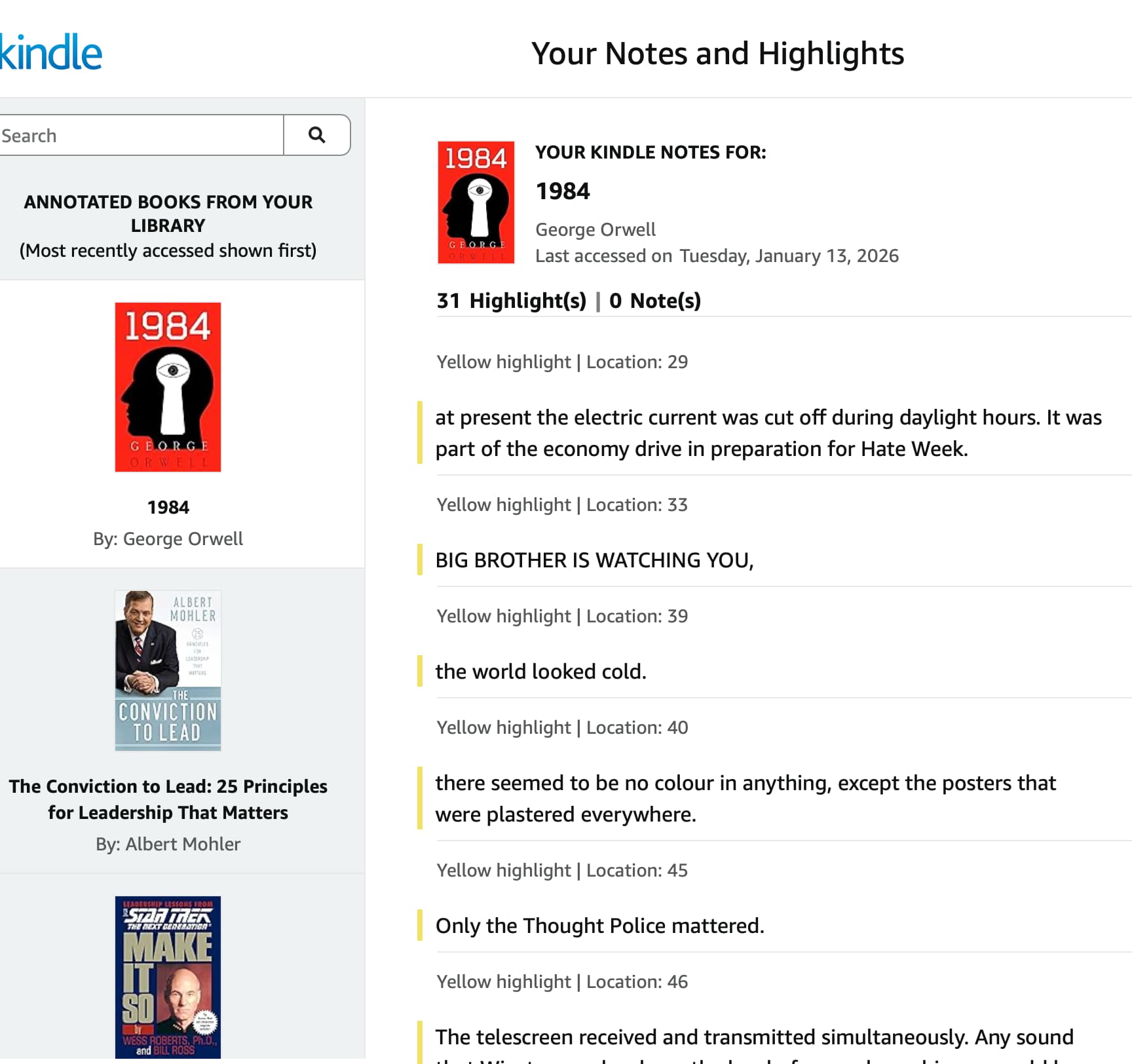

Certainly. You need to log in to your account, then go to: \https://read.amazon.com/notebook. You will be taken to a page with all of your Kindle books on the left. Click on one, and then you’ll see your highlights and notes on the right.

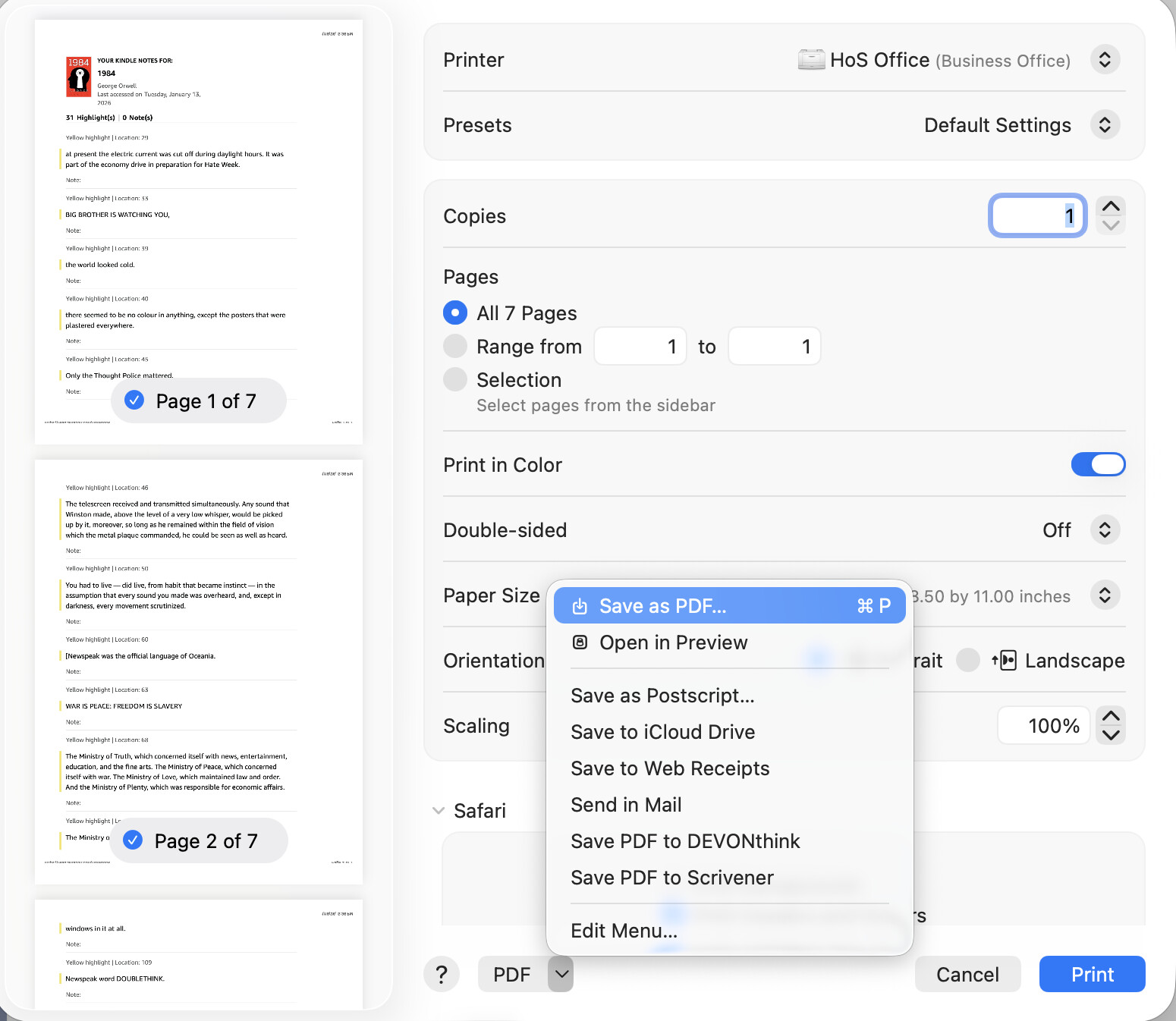

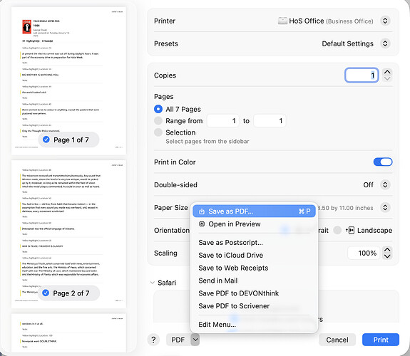

Then Print/Save as PDF
I added all the PDFs to DEVONthink for several reasons, but one of them is that DT automatically OCRs the PDFs when imported. This feature allows me to search across all the highlights and notes from my books. Additionally, I can create Smart Groups in DT for specific topics.
