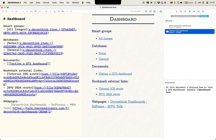

@svsmailus A lot depends on what exactly mean by ‘dashboard’, of course, but if you’re thinking mainly in terms of a simple table of contents for easy navigation, then there’s quite a lot built in. (Sorry if some of this is a bit basic – I’m not quite sure how much you already know!)
Here is a simple Markdown file, with side-by-side preview, and the Links Inspector on the right, with outgoing and incoming links.
This took about 2 minutes to set up: all I had to do was drag the links in (or use Hookmark) and everything else is automatic.
The links section on the right is fairly straightforward – there’s a context menu attached to each link so you can do various relevant actions such as open it in another tab / external viewer etc.
The next panel along – ‘Mentions’ gives you the ability to see the context of an incoming link. E.g. in the screenshot below, you can again see the links incoming from other documents in the database (Mentions), but this time if you click on one you see the a few words of context in which the link is embedded (Occurrences):
So, you get a lot of useful information just from the simple act of embedding the links in the ‘Dasboard’ document.
