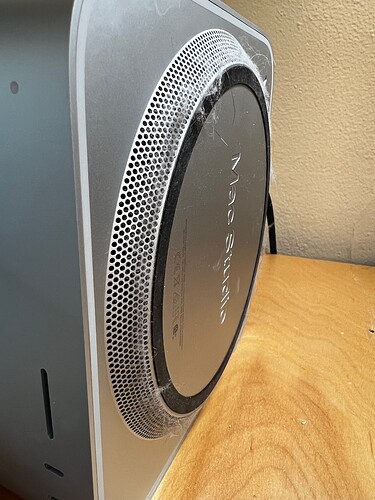

Holy smokes, thanks for posting this as it reminded me to check my Mac Studio. After not even 2 months, the cooling intake is seriously impeded by dust and cat fur:
Here’s the pile I wiped off the intake:
I had planned to check this in 3 months, but yikes! I have 90-year-old house and two cats, so despite the HEPA filter on the furnace and the standalone air cleaners and my regular cleaning (really, my house is clean!), it’s dusty. Much more so when I have the windows open regularly (I haven’t opened the office windows yet this year). And it doesn’t help that the Mac Studio is on my cats’ flight path to the window.
I really hope that most of this debris is sucked in because dust/fur lands on the surface of the desktop around the enclosure. If so, that would mean that elevating it on a platform that doesn’t extend beyond the edges of the enclosure would cut down on the buildup. As a quick fix, I found a small box that only extends about an inch, and that’s where it will stay for now. And I guess I’ll turn it off every night, too.
