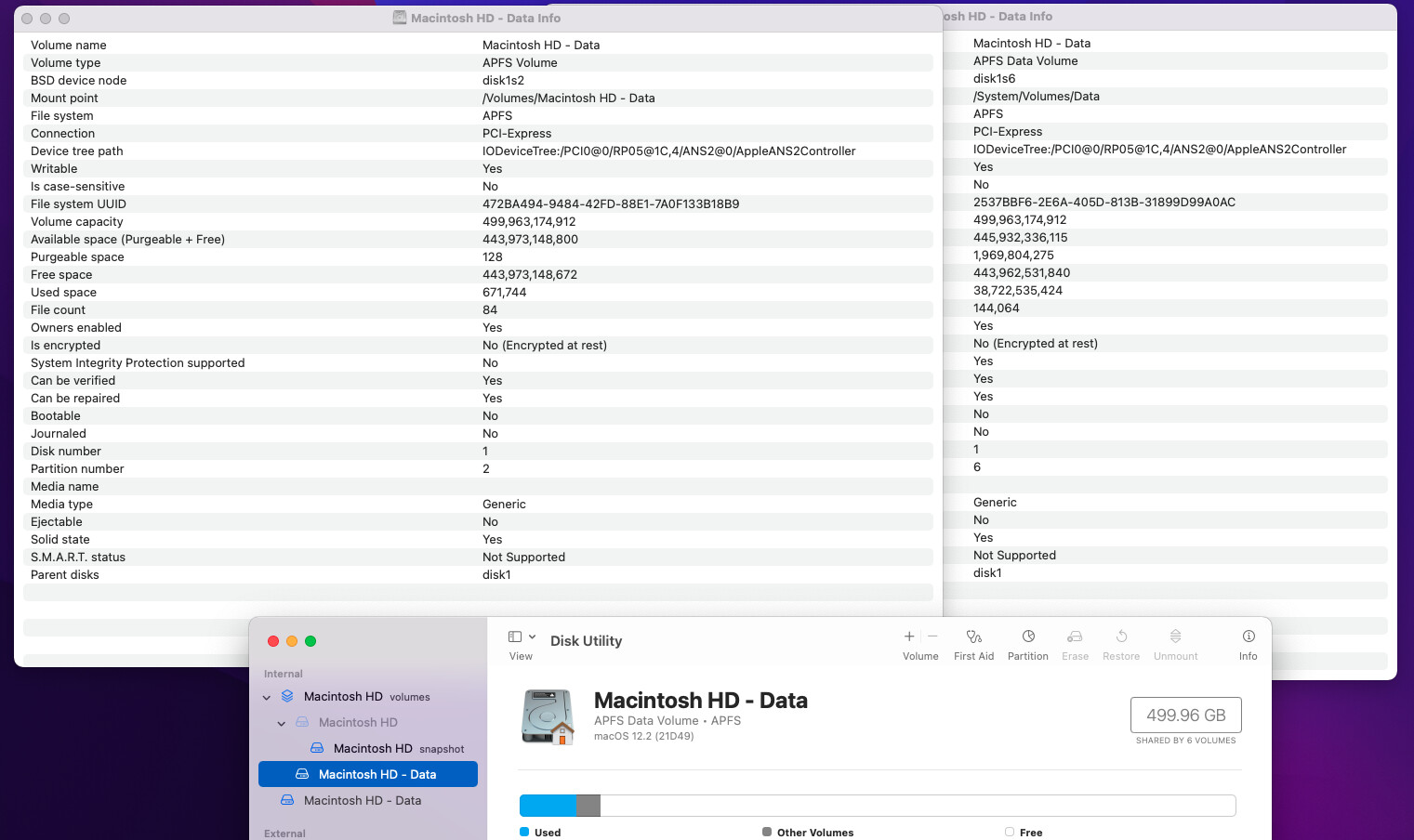

I recently installed Monterey directly over Catalina on a 2020 MBP. I have a weird (weird-to-me, anyway) volume structure and I don’t know if something’s wonky. So I made two different backups and reinstalled Monterey from the recovery disk. Same structure.
Is this normal? And if not, since a reinstall did not work, does that mean I’m headed to NukeAndPave land?

If you click on each of the Data drives, what information do you see? (as in size, etc.)
I erased the drive and did a clean install of the OS. I still see two Data drives. This screenshot shows the “get info” for both of them — the one on the right is the data drive within the “Macintosh HD volumes” container, and the one on the left is the data drive that is lowest on the list in Disk Utility.

There is one mounted at /Systems/Volumes/Data
and one mounted at /Volumes/Macintosh HD-Data
The one at /Volumes/Macintosh HD-Data can go.
