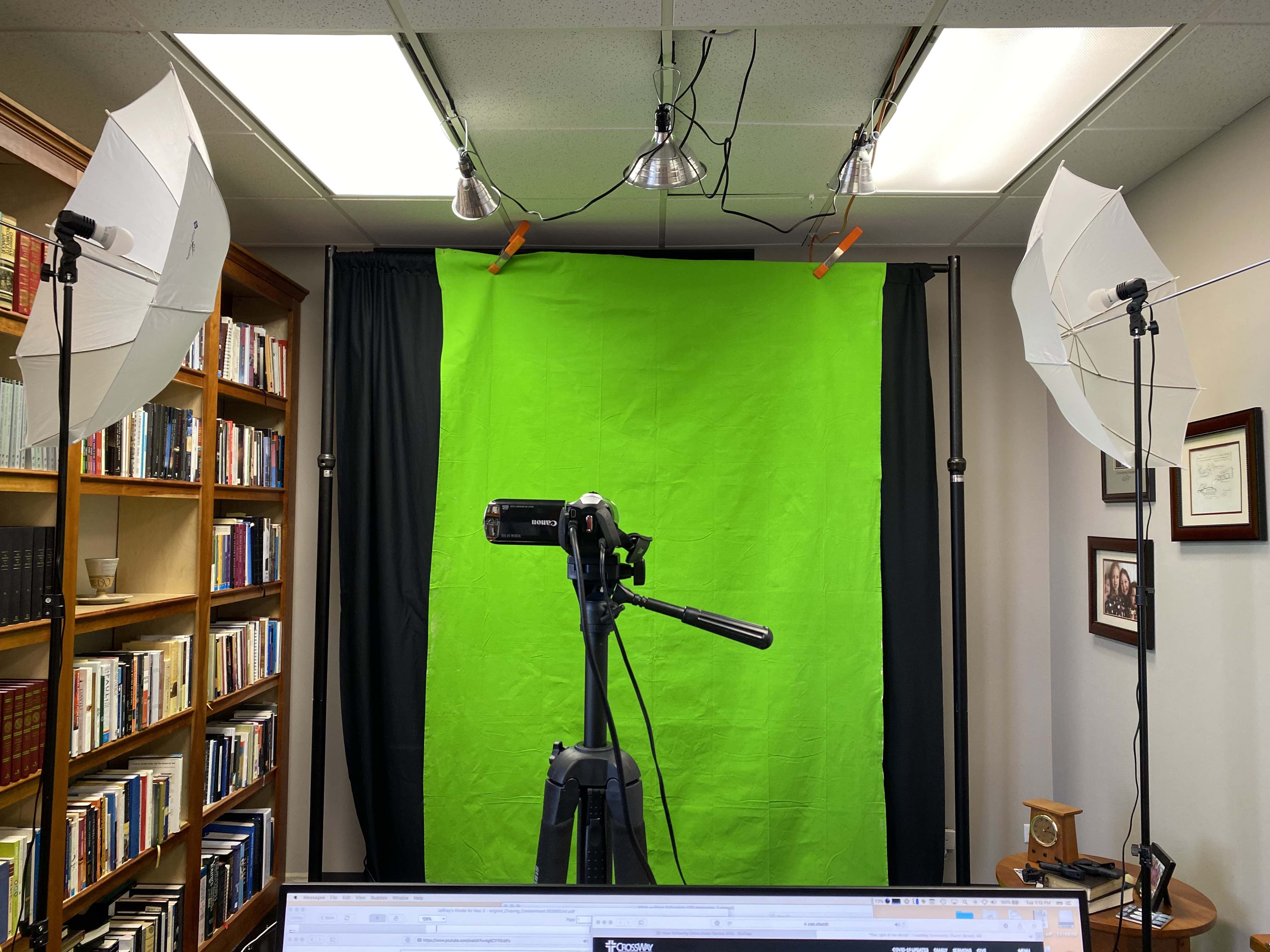

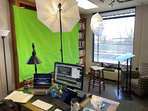

Lighting is really important as it is in any video. I tried to record on the green screen with too little light and Screenflow 9 couldn’t pick up the green correctly for the chroma key. When there is enough light this isn’t a problem. In the pic you can see the lights I used, I bought 100W equivalent LED bulbs and put them in the clip lights. I also have some small LED work lights that I use to light the green screen itself. To eliminate shadows, make sure to use enough light on the screen and stand far enough in front of it so you don’t cast a shadow.
