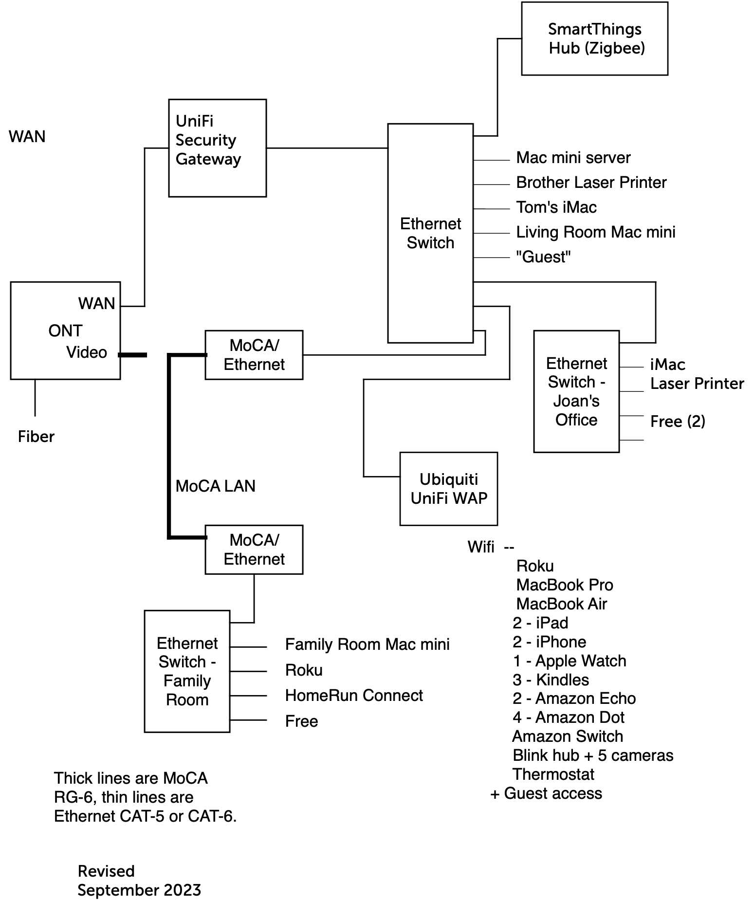

I’ve had network wiring of one kind or another for about 30 years at home, so it has changed a lot over the years. Currently have fiber service (100/100) for Internet. Ubiquity UniFi Security Gateway for the router and UniFi WAP for wireless. 3 Ethernet switches spread around the house with quite a bit of CAT-5 or CAT-6 wiring. One stretch goes through RG-6 and MoCA. The networking has always been rock solid, at least since I dropped my ISP’s Router/WAP that had many reliability issues. Goal is to get as much as I can wired rather than wireless.
Not really expensive or complicated, but fairly extensive. Worth the effort.
