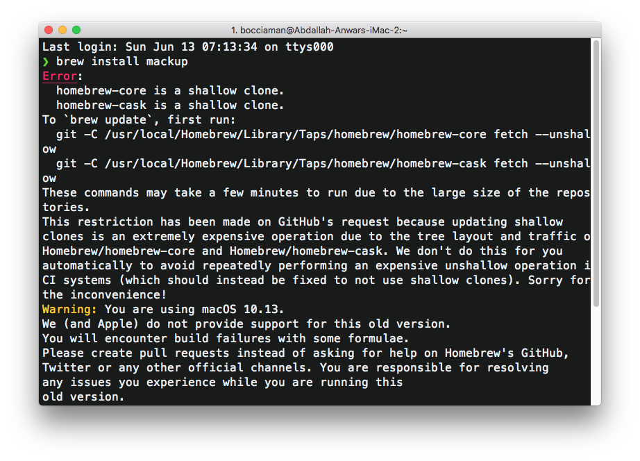

I run into this bottleneck all the time now.
What version of Homebrew is this?
Its version 3.0.0.
Did you already run the two suggested git commands before running brew update?
I also get the macOS 10.13 warning on my old Mac mini, but Homebrew still seems to work (though it has to compile way more stuff now).
Ya, same here so I guess I should be okay with it.

While you have quotes around this, what it actually says begins with:
Please note that these warnings are just used to help the Homebrew maintainers
with debugging if you file an issue. If everything you use Homebrew for is
working fine: please don’t worry or file an issue; just ignore this. Thanks!
So just do that last bit - ignore it :slight_smile:
