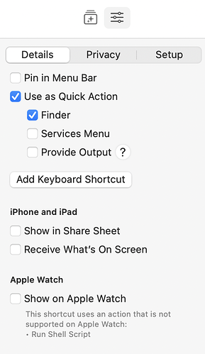

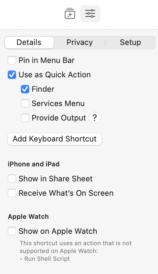

It’s meant to be used as a Quick Action. After you install it in Shortcuts, you may have to adjust its settings in the Shortcut Details sidebar to look like this:
To use it, you right-click (or Control-click) on the directory whose structure you want to copy. When the contextual menu appears, go down to Quick Actions and select Duplicate Directory from its submenu. You will soon see a new folder on your Desktop that’s named using the current date in yyyy-mm-dd format (e.g. 2022-04-09). Inside that folder is the directory structure you want. (The extra outer folder is there in case you ever want to copy the directory structure of a folder that’s already on your Desktop.)
You’ll probably need to give it access permissions the first time you run it.

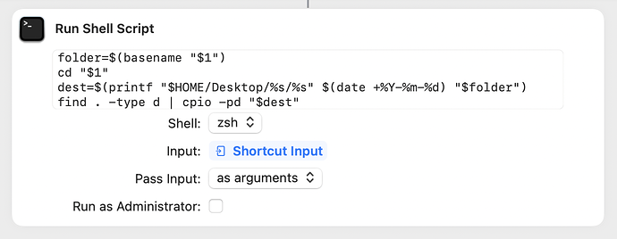

The shortcut has just one step, a shell script:
The input is the directory path to the selected folder, which is passed in as an argument to the script. The script is
folder=$(basename "$1")
cd "$1"
dest=$(printf "$HOME/Desktop/%s/%s" $(date +%Y-%m-%d) "$folder")
find . -type d | cpio -pd "$dest"
The final line of the script is basically @nlippman’s suggestion above. The main difference is that I used the cpio command instead of mkdir to build the directories from the results of the find command. It’s a little cleaner than dealing with xargs.
You might consider this cheating, as I’m just hiding the Unix commands in a Shortcuts wrapper. But to me, making shell commands like this more convenient to access is one of the best uses of Shortcuts (and Automator before it).
As I say, it works for me, and I tried it out on a variety of directories. Let me know if you run into any problems.

hi, I’ve tried this in Sonoma and it duplicates only the top-level folder, not the contents of that folder. Could I be doing something wrong?
I’ve opened the shortcut in Shortcuts and I see that there’s nothing selected from the Input menu. If I try to choose Shortcut Input, it appears in the menu briefly, then blinks out of existence.
Perhaps Sonoma broke something?
