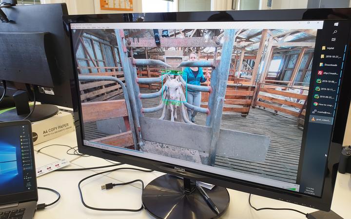

First article talks about Cambridge and determining stress in sheep. That is also where they studied sheep and discovered that they can recognize roughly 150 faces as individuals whether human or other sheep. One reason sheep learn their shepherds.
Second is exactly what I am thinking of but my use case is more interactive. THANKS for that link. Most of the cool sheep research from NZ is not allowed out of the country (I’m looking at you CARLA testing) :sigh: but that one might be because so few folks will use it.
