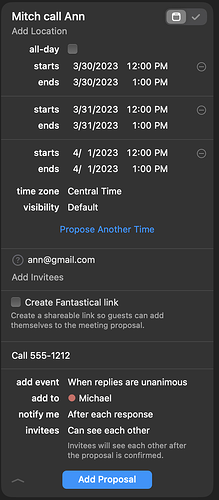

I would use a proposal for this, not an opening. A proposal is a one-time set of options for just that meeting, so it doesn’t create clutter for it to have a custom title/notes.
To create a proposal you just add options to a regular event, like so.
And it fills up your calendar until you commit to one time.
After you’ve committed to the time, you won’t see any trace of the proposal in Fantastical unless you want to make a Mitch/Ann template for future proposals.
