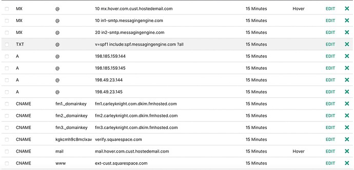

Hello, after hearing about Fastmail on MPU today, I decided to try it out, but I’m hitting my technical limits. I have a domain that I host through Hover that is currently on Google suite for email. I want to switch it to the Fastmail one. I thought I updated the DNS records correctly, I can provide a screenshot, but I’m not sure that would be a good idea. Do I just need to wait for the DNS records to switch? Do I need to disconnect Google first? What should I do, I’m lost.

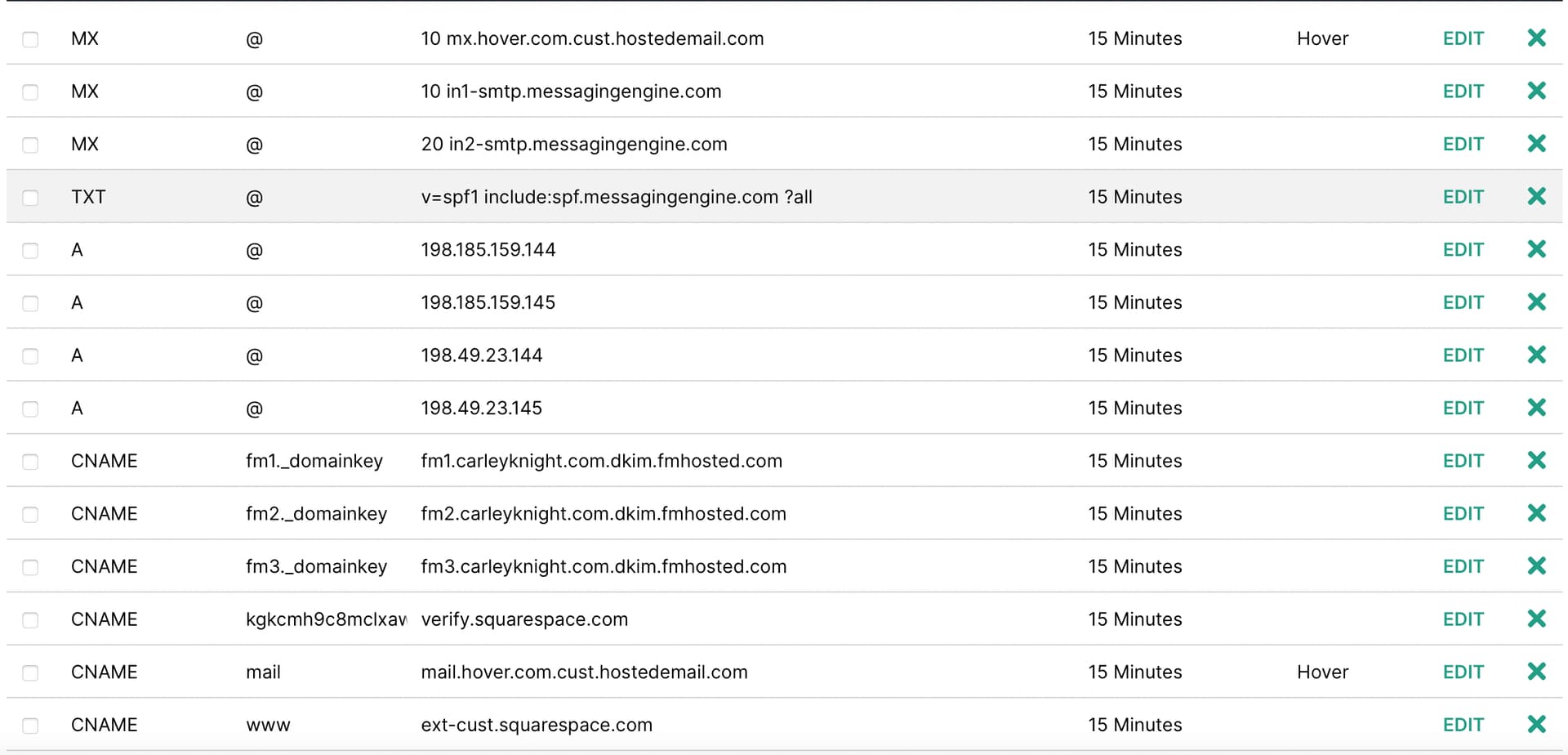

good to know, here is my DNS records, I’m not sure what I did wrong
Have you looked at Fastmail help and FAQ? For example, https://www.fastmail.help/hc/en-us/articles/1500000278002-Setting-up-your-domain-NS-MX Might help.
I can see Hover Hosted email in there as well. Too many records. Take the MX and CNAME records with hover in them out and see what happens

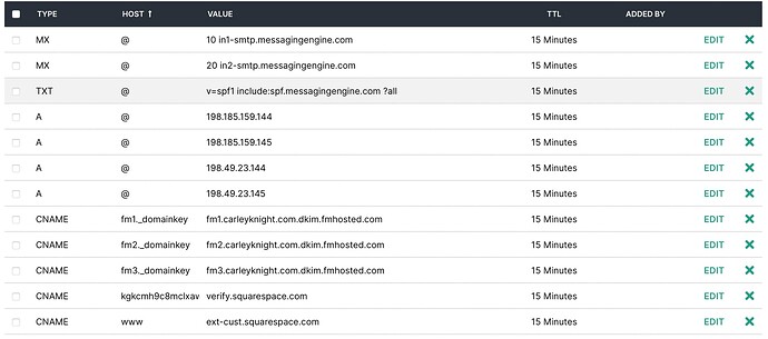

I think I got them all, :crossed_fingers:that this will work

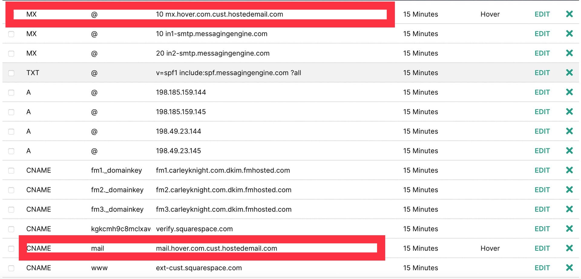

Hello @iglified I was preparing this reply for you. I recommend removing the highlighted records. I think you already did, just publishing in case things are still not working.
thank you so much everyone! It is active!
