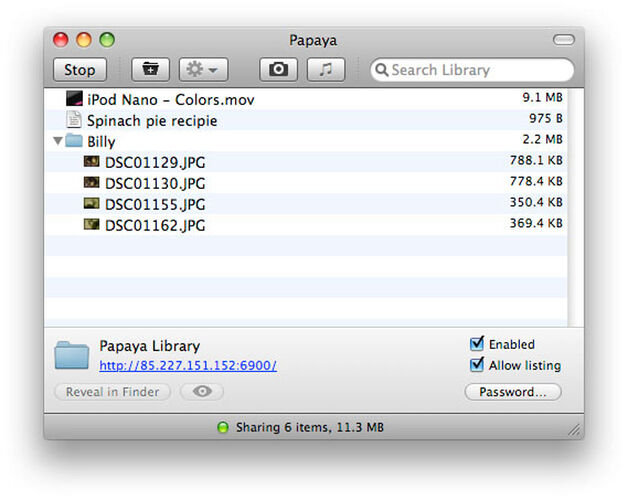

There used to be this fantastic app called Papaya where you started a webserver to share files with friends. You just draged folders and files to it and started the server and it gave you a link, you could also put password on it.
I know these days you have cloud services, but then you need yo upload first, and then share. Ive had instances where icloud takes a long time to generate a share, speed goes up and down etc.
There doesnt seem to be any thing like this app anymore? It was just so much easier and faster, no need to upload, no need to remove the files from the cloud etc.
It doesnt seem to work anymore. :frowning: Papaya 1.3.2 - Download for Mac Free

So this papaya software did not upload anything it created a webserver with a link. Just drag the files and share the link. The person who went to the link would end up on a website hosted on you computer with download links.
And the whole point is to not have to upload. Like if you want to send Apple Proraw video for a friend to help edit? You would have to wait for the upload and then share, upgrade your storage space and the delete from you cloud share.
All other options that comes close to it uses the app on both server/client side.
Isnt it strange that it doesnt exist anything like this anymore? Has Apple sandboxed away the possibility to launch a small webserver?
Im also curious about how it did work. Is there any network specialists here that can explain how it did work and if its not possible anymore to open up a port and host a website with download links?
It’s entirely possible to do this manually.
  1. Setup the built in Apache web server which already exists on your Mac
  2. open port 80 and/or 443 on your mac’s firewall
  3. Set up NAT on your local LAN Firewall which connects your home to the internet to forward port 80/443 to your Mac
  4. Grab your Internet facing IP Address on your local router/firewall
  5. Setup a username and password on Apache to allow access to your local machine
  6. Host the file you wish to share on your local web server
  7. send an IP Address link, username, and password to your other person to download the file
  8. Hope your Router/firewall IP Address doesn’t change.
I suspect what Papaya added to the mix, is that it made you install some software locally which communicated your router/firewall IP address to a internet based web server in case your IP Address changed, and the link you sent to the other person was for the internet based web server which redirected them to your local IP Address. Either that or it used something like DYNDNS

So i spent half a day with Chatgpt and managed to use an old domain i had to put up a cloudflare tunnel, connected to homebrew app Caddy. Works perfectly it creates a webserver and puts the files from the folder in that website.
Which software do you use for the webserver?
