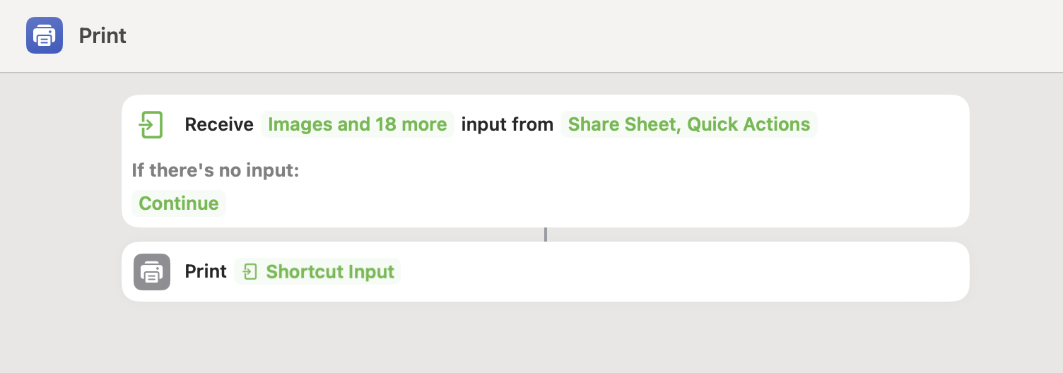

The above methods print directly to the nominated printer. If I want to open the print dialogue before printing the only option that has worked for me is an Apple Shortcut placed in the share sheet.
