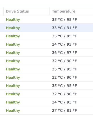

I have a 12-bay Synology NAS with Synology Hybrid Raid configured. I started with 6 4Tb drives and over the last 5 years it has been filled with 12 16Tb drives. In all that time I have had only one drive which developed media errors so I replaced it; none have failed.

What kind of NAS is it? Does it monitor drive temperatures - if so what does it show?
I think heat is my problem. My drives are refills running in the high 40s to low 50s. I think i’m going to move the NAS to another location that has better temperature control and air flow.
I’ve had my Synology DS918+ running since December 2019 with 3 drives and not had a failure yet. They’re sitting at 24°-25° C right now. I don’t push it hard, but my Air does an Arq backup to it hourly when it’s awake and I run Plex & Jellyfin for the house off it.
