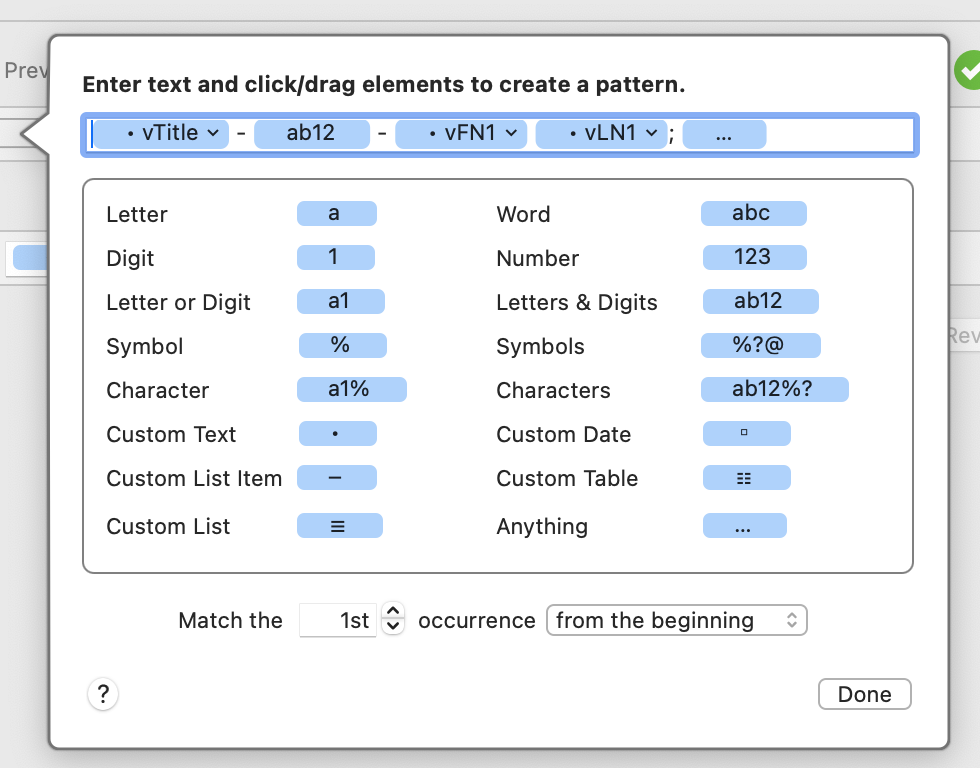

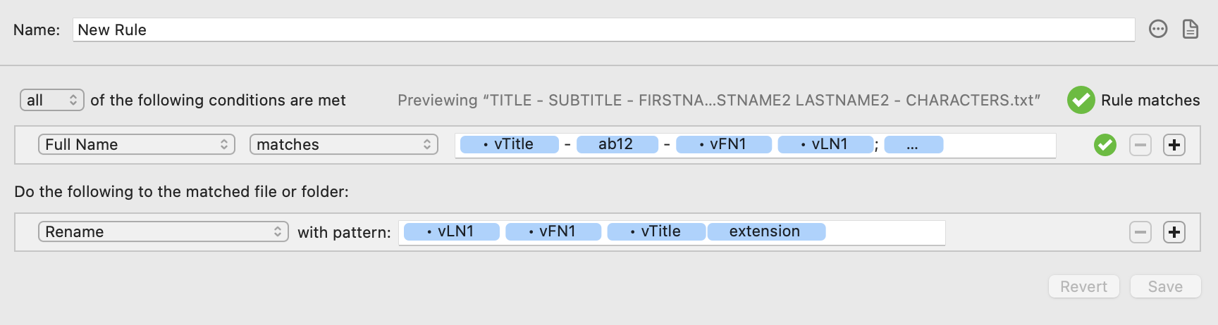

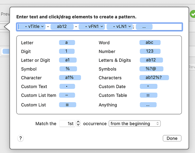

I quickly hacked together a first draft:
Assuming the pattern of your starting filename is quite strict, this could be a starting point.

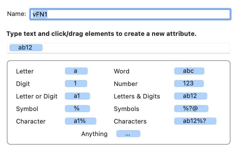

With the “matches” action, you can use Tokens to pattern your filename and reuse those tokens for the renaming (sorry if the wording might not be quite correct):

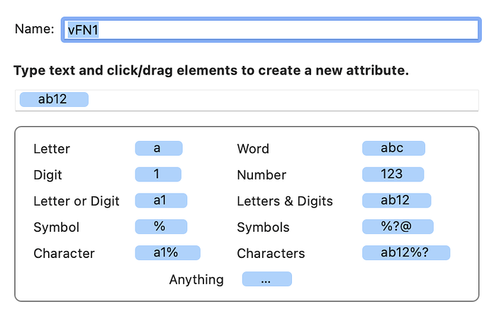

For the “v…” patterns (vTitle, vFN1, vLN1) I used the “custom Text” token:

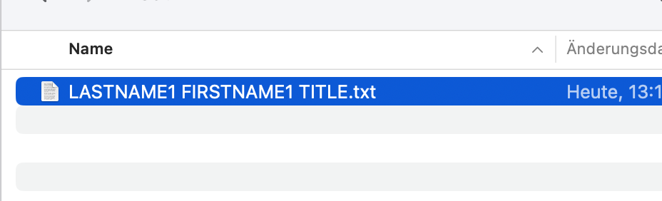

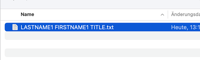

And at least in this very perfect scenario it works :slight_smile: :
Resulting in:
Hopefully this gives you a starting point?
