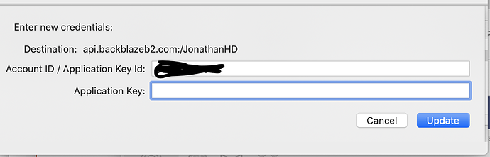

So the problem is that my B2 application key needs to be refreshed. When I click in Arq I get the following message:
In other words I need to find my secret key. Not sure if this is able to be found on my B2 account.

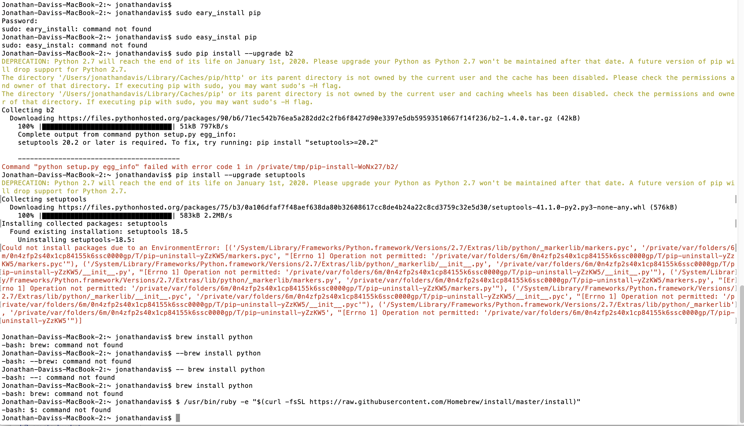

To @JohnAtl and @tjluoma’s credit, I made an error. I need Python to run B2’s command line tools as of here:
https://www.backblaze.com/b2/docs/quick_command_line.html
In trying to use the terminal to instal the B2 command line tools, I get the following issues in terminal:
Hopefully all the detail I’ve provided in this comment is enough to go off of for next steps or further help. My apologies for not providing so earlier.

I believe you can retrieve that key from the BackBlaze website; there should be a way to do so under your account information or the B2 menu (left hand side of the main screen).
I wonder if you can repair your install if you have deleted python 2.7? (That should be relatively hard to do given where the system files are stored in Mojave, I would have thought.)
So I went to the Python website as @DaveyGravy suggested and downloaded them just fine. Installed 2.7 and 3.whatever version. So on that end I’m all good.
I doubt if you uninstalled Apple’s copy of Python 2.7, as I’ve heard that breaks things in a major way and requires reinstalling macOS. It looks like you can use the default install for the B2 command line tools. Unless you have other reasons to install Python 3, I’d just go with 2.x for simplicity’s sake.
Installing Python is one of the biggest pains in the butt I’ve encountered since leaving Linux. Anaconda, environments, package managers, conflicts between the decade-old v. 2.x and the new 3.x versions. It’s kind of nuts. I might want to use Python in the future, but there’s so much overhead and heartache that I’m sticking with MATLAB and R at the moment, and avoiding 3.x for the time being.
I got the B2 command line tools running so that’s good, just need the keys
Ok let me outline what I want:
I already have 3 B2 Cloud Storage Buckets. I’d like to still continue backing up to these storage buckets so I don’t have to start over. If I don’t know the Application Key what are my options? Can I create a new one and have it backup to an existing bucket? Once 1pm PST hits I will see about chatting with B2 support to figure out what next steps unless anybody else has an idea. What should have been a simple process is a bit more involved but thankfully I have the day off work to do stuff such as this.
Alright so Christopher from Backblaze support (he’s awesome!) was able to lend a hand. So luckily in 1Password I had my Master Application Key and Account ID saved. I generated new keys as ā€œadd a new application keyā€ and then saved them in my notes section in 1Password. All is well now and things are going to backup tonight. Might take a couple days of backing up at night to catch all the way up but it’s working. Now on to reinitializing my Carbon Copy Cloner backups.
