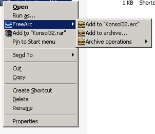

BTW, FreeArc seems to be loaded when the system starts, since it’s available in all right menus:
I know there must be a service that is started with this system that I have missed! :grimacing:
