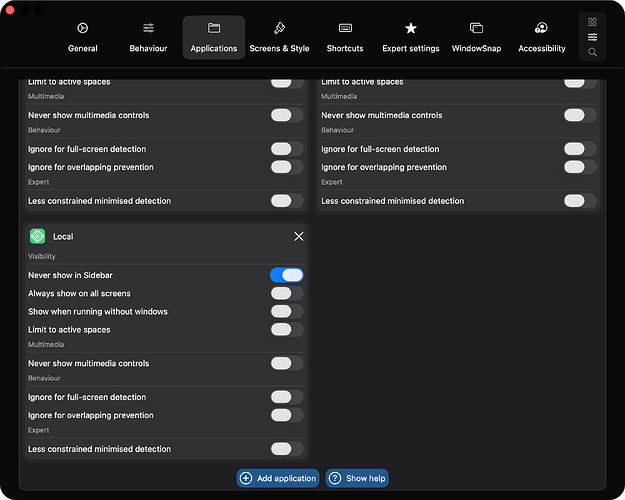

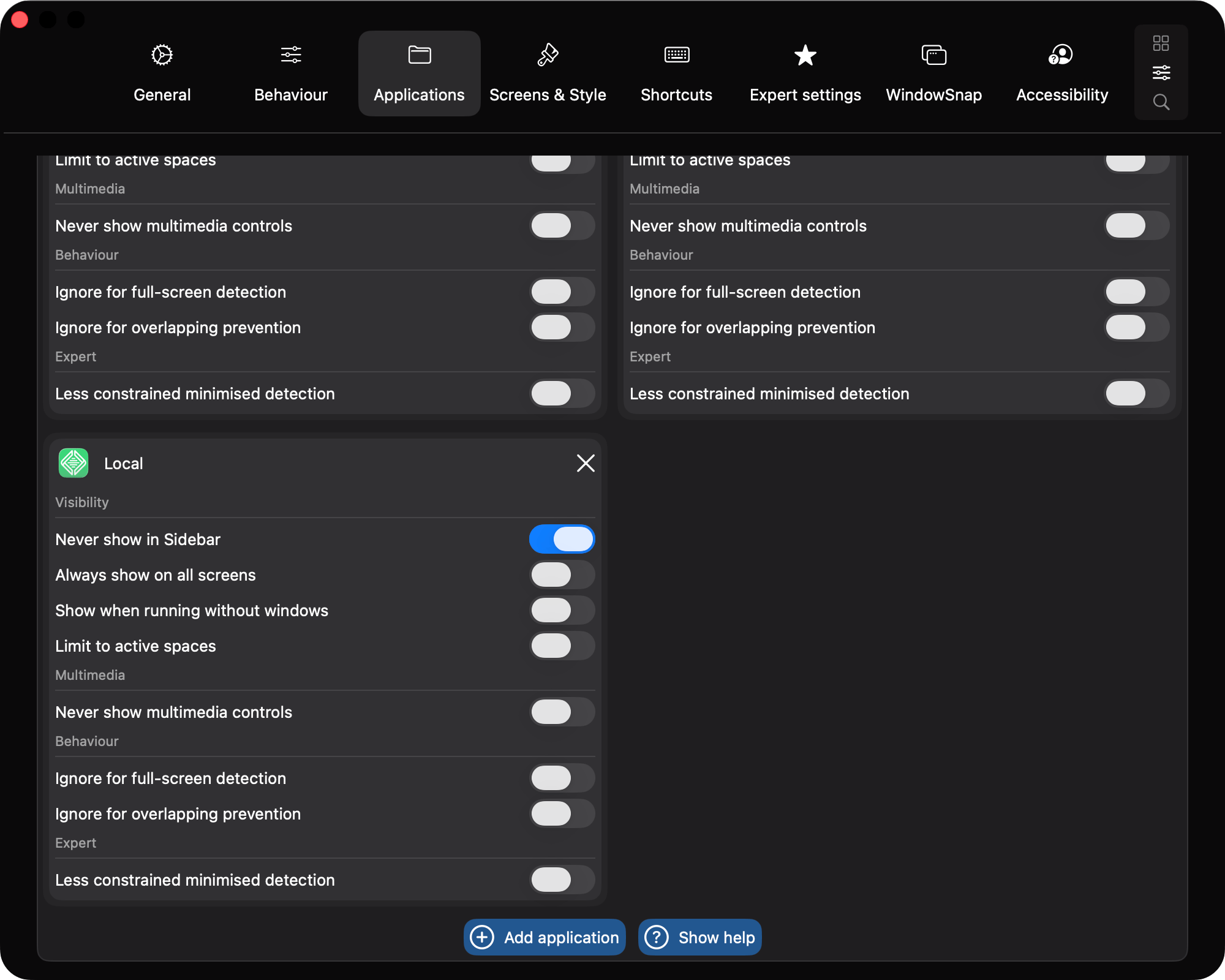

I am now using Sidebar (in Setapp) for this and automatic space-specific dock.
+1 for Sidebar here - great utility that doesn’t get mentioned often.
yes, the amount of details that have gone into it is impressive. I wish its settings interface looked more macOS-like though.
