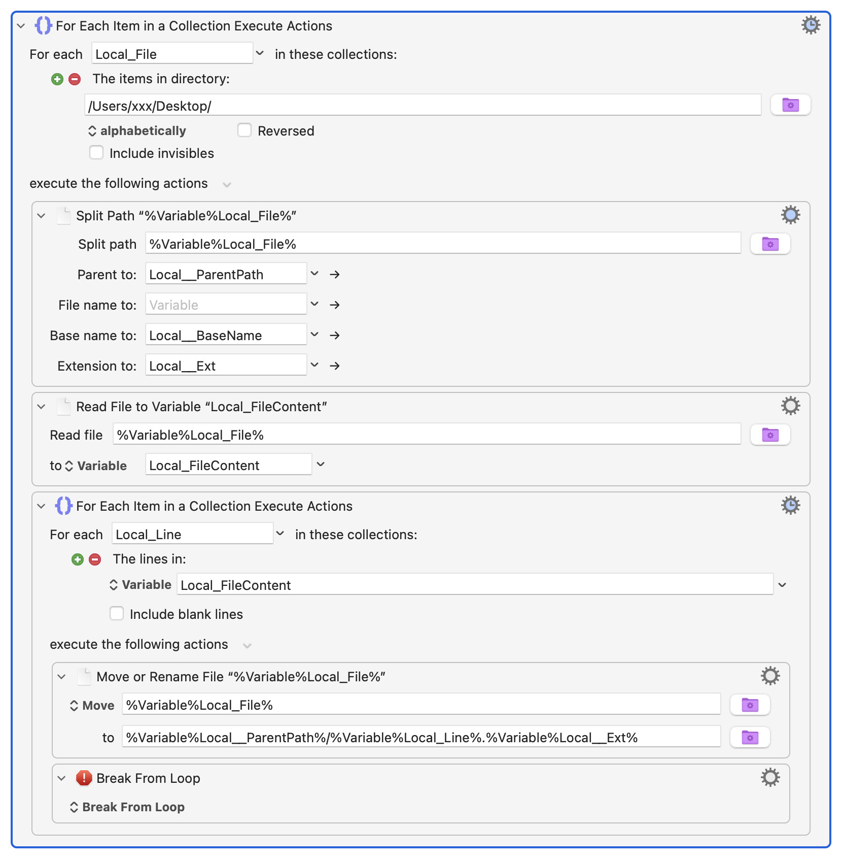

EDIT: Updated with working macro that should work by grabbing only the first line of each txt file🤞. Thanks to @rms for catching the error.
Here is a KM Macro that will do what I think you want without regex or scripting. It assumes all files in the folder are non-empty txt files, but you could (should) add some error checking to handle files that aren’t txt or txt files that are empty, etc. But this should get you started. Change the path in the first For Each action to the target folder.
Download KM Macro
Nice, but I don’t see where you read the first line of the content of each text message to get the file name, as the OP @dealtek wants. Can you pls point me to that new-to-me line in the macro. The “read file” command reads only the first line? thanks.

Whoops. I think the macro accidentally worked with the test files I used :rofl:
I will update the original post with a working version.

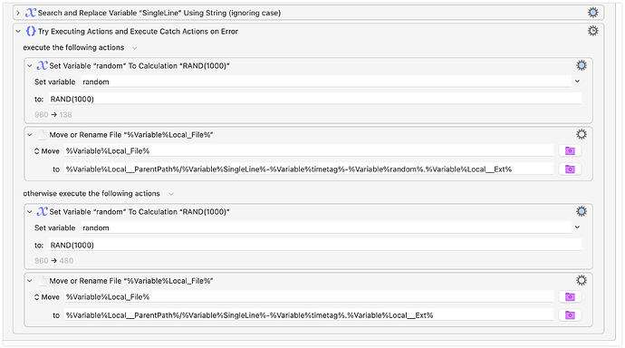

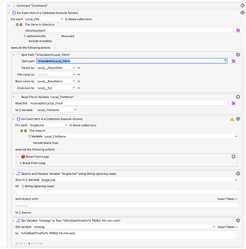

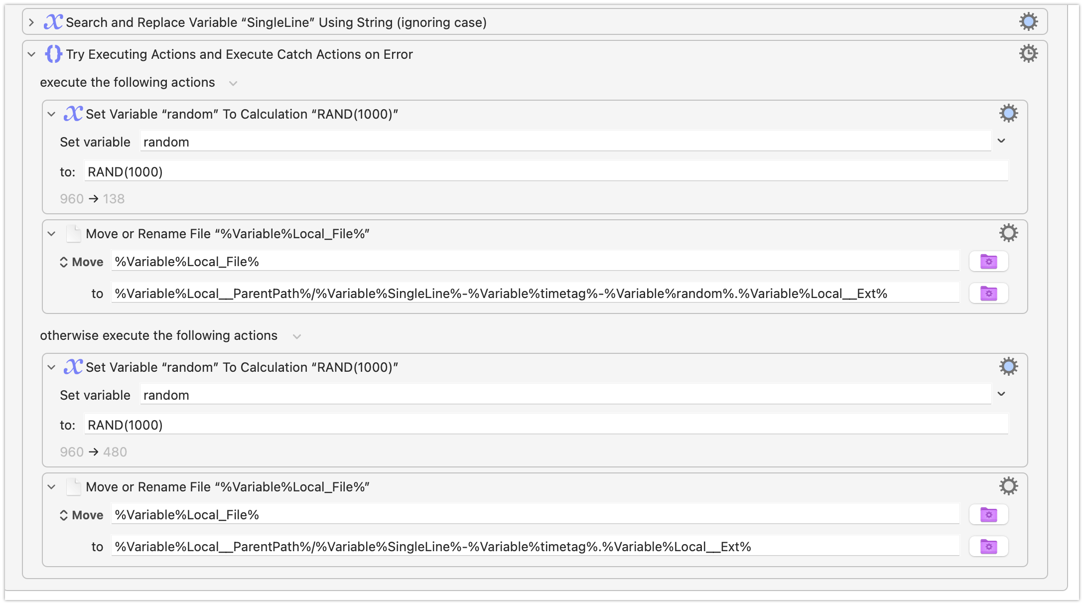

Hi Evan, I used your very good macro and made some mods with suggestions from PeterLewis and came up with this example (still a work in progress). Peter suggested :
Or you can use the For Each action and the Lines In collection to read the lines from the file, and break out of the loop immediately.
Also if you can let me know the best way to save the macro safely (so it does not load as enabled…) I will export and upload it.
