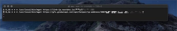

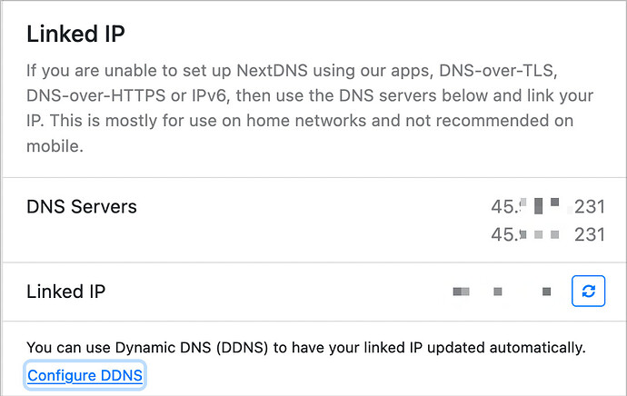

@JohnAtl and @anon41602260 - it seems the commands are not running. Does the terminal window need to be open for the commands to run?
This is what I setup:
What does give that impression? (IP’s not correct?)
Is what you’re showing the output of crontab -l?
Do the commands work on the command line? (For example is wget installed, in /usr/local/bin?)
