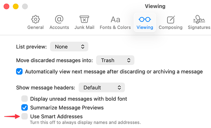

In “Viewing” settings, I have “x-envelope-from” in view, and "Use smart addresses disabled.

If you disable “Use Smart Addresses” in Settings > Viewing, Apple Mail will display recipients’ names and email addresses.
Read my post again. I already disabled smart addresses. That only affects reading view, not composing view.

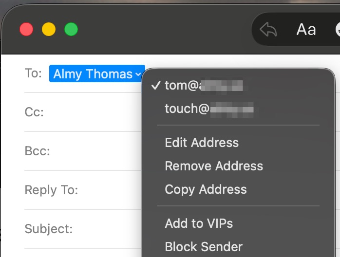

When I compose a message, the names in the To field have a dropdown that shows the selected and available addresses for the name. If I select “edit” it will show the name and address in the To field.
Correct. So what I want to accomplish is to not have to click on anything in order to reveal the address. But rather, the recipient email address is displayed by default.

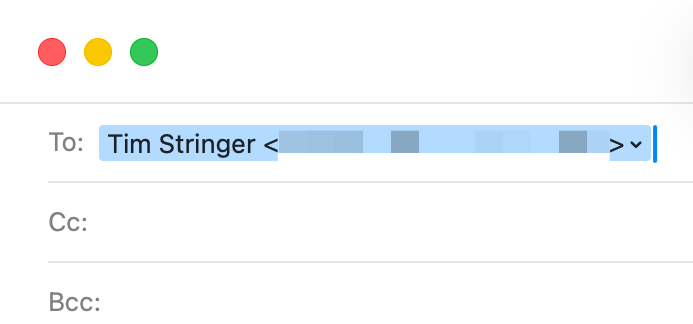

When I compose a message with “Use Smart Addresses” disabled, the recipient’s name and email address appear in the compose window as I would expect (I apologize for not noticing that you’ve already tried this setting); I don’t have to click a dropdown to reveal this information.
