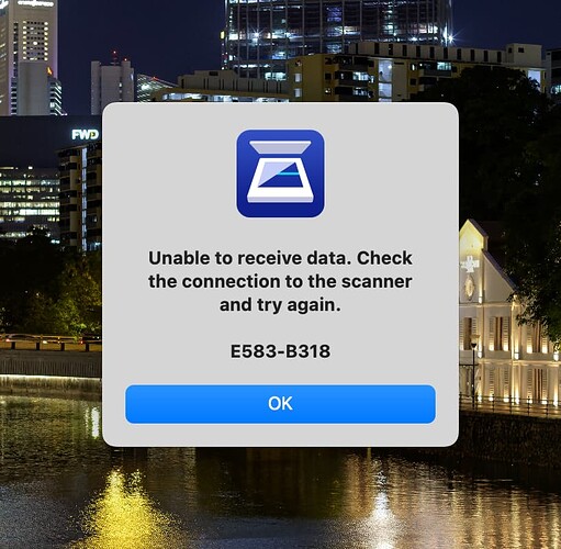

However, when I want to scan slides and negatives, this problem rears its head. The scanner will work for some period of time before this error appears. It can sometimes appear on the very first attempt to preview, or sometimes after many frames of full resolution scans.
At this point the scanner just sort of “pauses”. I think it’s waiting for the computer to tell it what to do next, but the computer (or rather software on it) has “lost contact” and will never tell it what to do next.

I have tried uninstalling and reinstalling ALL Epson software, and VueScan (which uses Epson’s driver) and I have tried lots of different cables into lots of ports (on the MacBook Pro, on the TB-connected Studio display, on my OWC USB-C dock, and with a StarTech USB-C travel hub).
In some configurations I have managed to get a decent number of frames scanned before it gives up, but it always gives up. At one point, scanning my Grandfather’s slides, I worked out I could quickly quit the Epson Scan software, turn the scanner off and on, then restart Epson scan and hit the go button again (after deselecting the frames I already had) and it would flawlessly scan the frame it crapped out on before.
