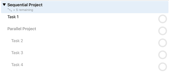

You can actually do both of these in OmniFocus by nesting parallel and sequential projects, though it’s a bit fiddly.
If tasks 2, 3, and 4 are waiting until you finish task 1: create a sequential project and put task 1 in it. Underneath task 1, create a parallel sub-project below task 1 containing tasks 2, 3, and 4. Tasks 2, 3 and 4 will be unavailable until you complete task 1, but once you check off task 1, tasks 2, 3, and 4 will become available in parallel.

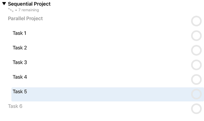

If task 6 is waiting on tasks 1, 2, 3, 4, and 5: create a sequential project, then create a parallel sub-project inside it. Set the parallel sub-project to automatically complete when the last action in it is completed. Put tasks 1, 2, 3, 4, and 5 in the parallel sub-project. Put task 6 in the sequential project underneath the parallel sub-project. Until you complete the parallel sub-project, task 6 will be on hold. When you check off tasks 1, 2, 3, 4, and 5, the parallel sub-project will automatically be completed, making task 6 available.
