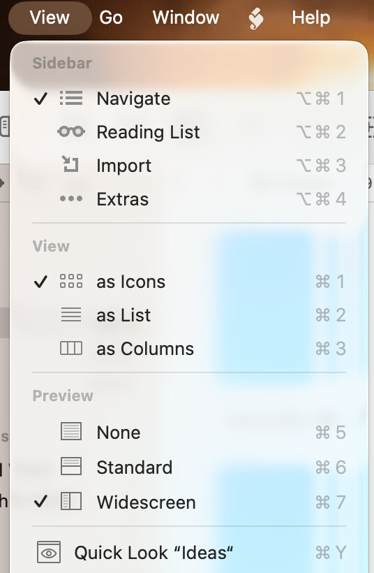

I do need a gallery view, though. Can I do that in DT?

It depends on how one defines gallery.

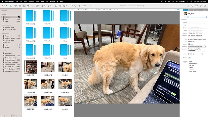

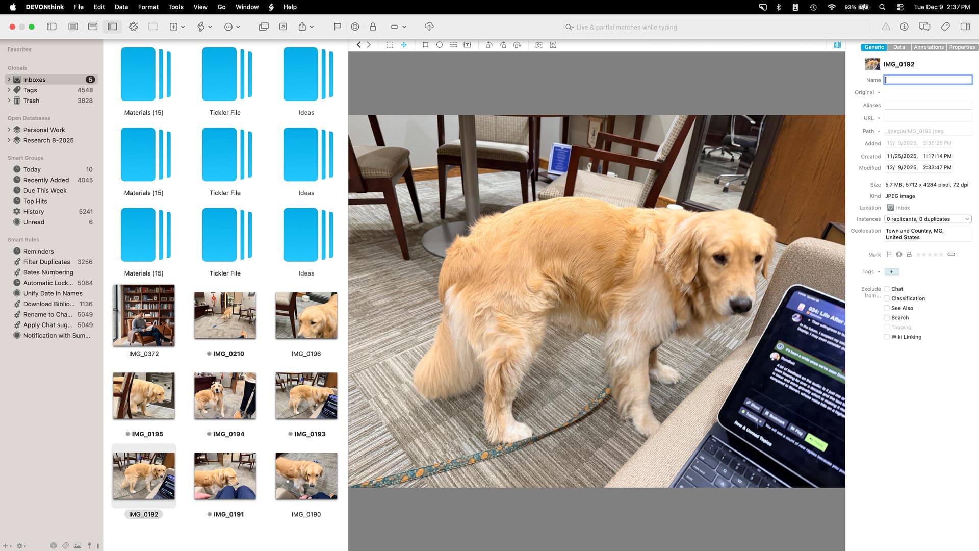

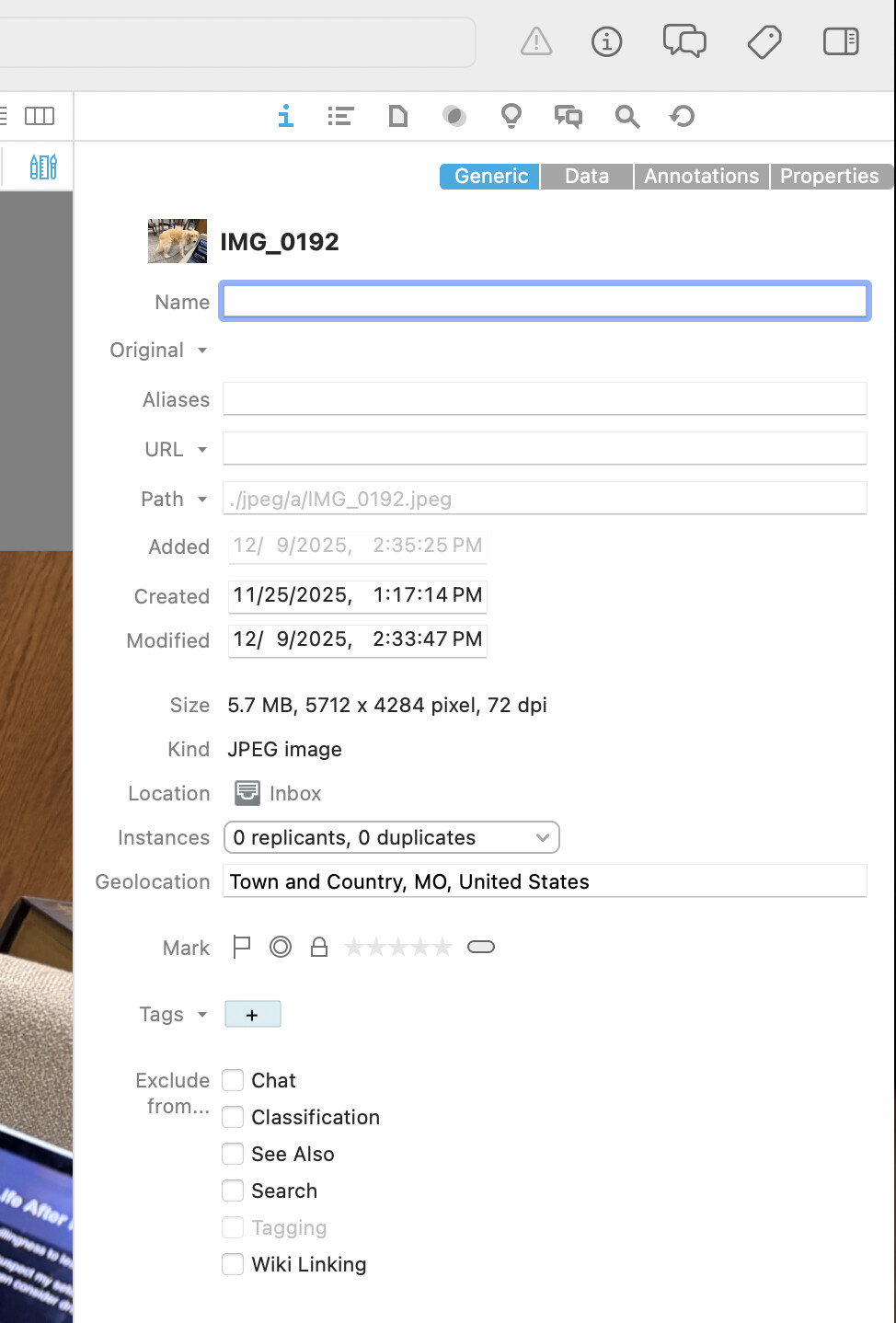

Below is a screenshot. I pasted a few random photos into the inbox. As you can on the right, you add all kinds of metadata and create smart folders from that information.
You can also create custom fields for additional metadata.
DT also has robust cross-linking for PKM use.
