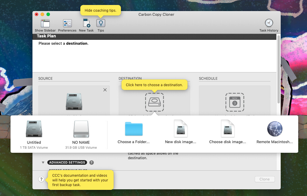

I had to install CCC5 as this Mac is on Mojave. I have selected the HDD as the source but the OWC SSD doesn’t show as a destination
How much of the 1TB of the HDD are in use?
If the “NoName” is the SSD, there are only 31,9 GB available, which would most probably not enough, to clone the drive.
“NoName” is not the SSD, it’s an SD card. The HDD has used 951Gb, the SSD is 512Gb but I only want to run the OS and applications from that. The HDD will be kept to store media files (my son is a videographer)

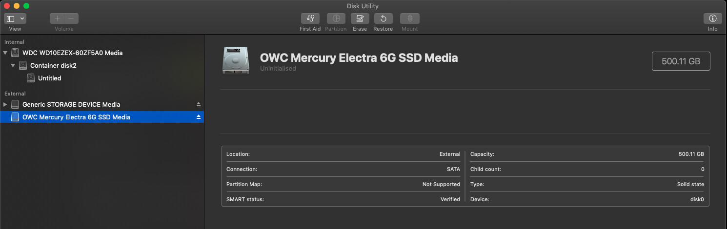

So, the SSD is not visible in your System right wow, right?
Try the DiskUtility and have a Look, whether the SSD is visible there.
It might be, that the drive is Show grayed out, in this case it has to be activated first.
It shows in Disk Utility as an uninitialised external drive

I formatted the disk with disk utility as APFS with a GUID partition map, it now shows as a location in the finder which is great progress!
