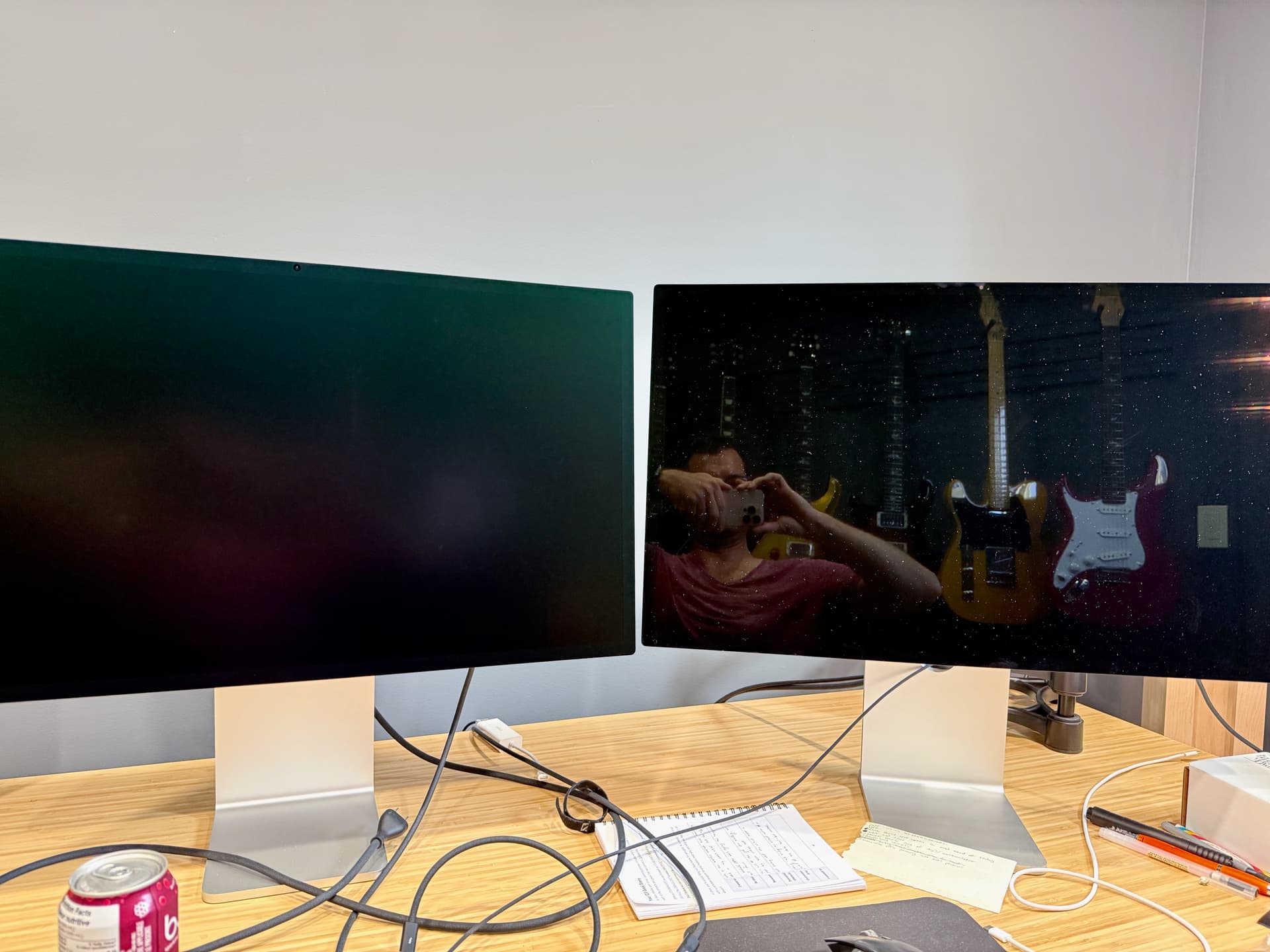

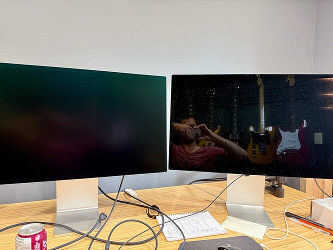

Just finished setting it up.
Below you will see what I’m used to on the right (honestly not as bad as normal, because it’s off-angle), and the new monitor on the left. (Pardon the dust on the Studio Display; it’s not as bad as it looks in the picture. But it is basically dusting and vacuuming day in our household, so it checks out.)
The first thing I have noticed is that the new display has a warmer cast than the other Studio Display I’m looking at. I recall the same thing to be true for the first Studio Display I got when they were released, as well as the refurb glossy model I ordered as a second display last year. They seem to have mellowed out over time. Or I just got used to them. But they definitely run a little warmer than I’m used to.
This display is also dimmer than my previous Studio Displays.
It just got off a 50 degree Celsius truck, so maybe it’s the heat and it’ll be a little different tomorrow once it’s not melting.
