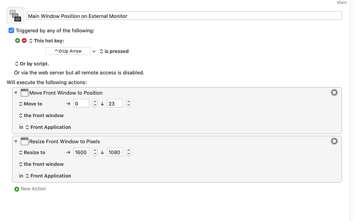

Hereās how I do it. Iāve got a 13-inch MacBook Pro with a 23-inch monitor connected to it. I use the external monitor as the main display, with the MacBook Pro off to the left. (That explains the negative number in the macro that moves the window to the MBP screen. I think. Itās been a long time since I made these.)
Shift-Control-Up Arrow moves the frontmost window to a fixed spot on the external monitor:
Shift-Control-Option-Down Arrow moves the frontmost window over to the MBP display:

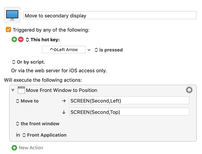

I do something similar to tonycraine, but instead use the SCREEN variable to distinguish how to move the windows (ex. Main, Second). Hereās how I move an active window to my second display:

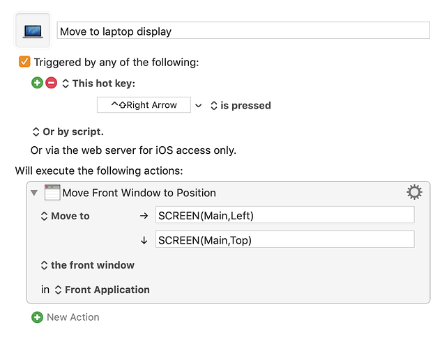

And how I move one back to my laptop:

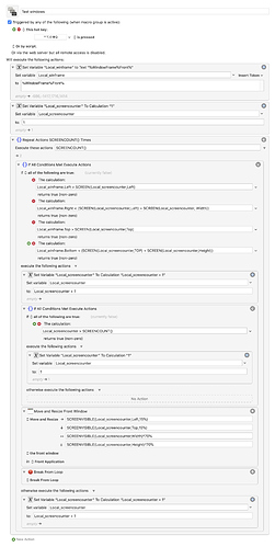

Attached is my first pass KM macro that uses one trigger to move a window from screen to screen. I have only two monitors attached at this time, so it is not tested on >2 monitors but I think it will work.
The idea here is to a) use a single hotkey (or other trigger) to accomplish moving the window from monitor to monitor in a round robin fashion (eg it cycles successively through each monitor in the order the KM assigns them) rather than having a separate trigger for each target monitor, and b) take into consideration various relationships between the monitorsā layout (for example on one setup I have an external monitor stacked above my laptop screen, but on my desktop iMac I have a second monitor off to the right).
Below the image is an analysis of how it works. There may be fence post problem; I need to figure out how to enter greater than or equal signs into calculations so the comparisons have to be updated when I find out the proper keystrokes (
Note that it is my understanding that in KM, the main screen is always index 0, and then the screens are numbered from left to right from 1 to SCREENCOUNT(). I donāt know how left to right is determined for vertically stacked screens, but seems to relate to the screen with the smaller coordinate for its left border (my external monitor above my laptop is much larger than the laptop screen which is centered below it and so its left border is at -872. Note that the top left corner of the main screen is at (0,0).
The steps are:
Get the āframeā of the front window (which is presumably the one I want to move). Saving this as text in a variable allows the elements of the frame (Left, Top, Right, Bottom) to be extracted in calculations. With this, I know where in the coordinate space that includes ALL screens the window is located.
The variable Local_screencounter tracks which screen I am looking at in the subsequent loop. It runs from to 1 to SCREENCOUNT(); the value 0 is always the Main screen but I ignore that as the main screen ALSO has an index in the above range.
Loop through each screen (SCREENCOUNT() times):
a) Check the listed conditions to see if the window (āframeā) is in the current screen. Note the present code requires that the entire window must be contained on the screen; if a window overlaps two screens this condition will not be met. I think the code is self-explanatory. I decided to do it this way because I wasnāt sure what I wanted to do with moving a window that overlapped two screens between the screensā¦you might want to modify to suit your needs, perhaps by defining the screen a window is in by where the top left corner is.
b) If the window is on this screen:
i) Compute the screen to move the window to. Add 1 to Local_screencounter to get to the next screen (to the right), but if the result is >SCREENCOUNTER() wrap back to screen 1.
ii) Move the window to that screen and put it in the middle of the screen by resizing it.
iii) Done, so quit the loop.
c) If the window is NOT on this screen, increment the Local_screencounter so we can check the next screen on the next loop iteration.
If we donāt find the window on any screen (which should not be possible, butā¦) then just fall off the bottom of the macro and do nothing. You may wish to put a notification alert here.
Note that the use of > and < in the comparisons is not correct, and these should be >= and <=, but I have to review the KM wiki to find out how to type that correctly in an a calculation field and update the macro. You will want to do the same.
