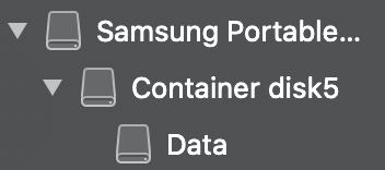

In the image below my volume is Data, the device is Samsung Portable.
