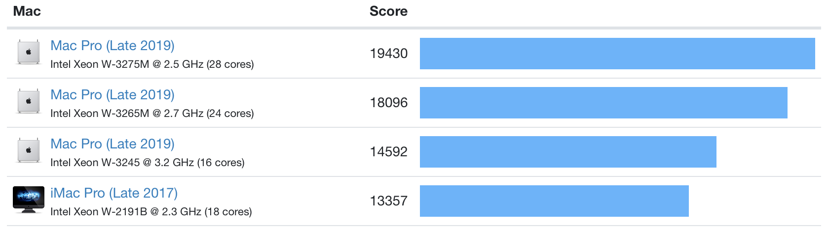

Just to put that in perspective, here’s the Geekbench multicore Mac leaderboard:
A 14,302 would slot the new MacBook Pro just under a Mac Pro with a 16-core Xeon.
