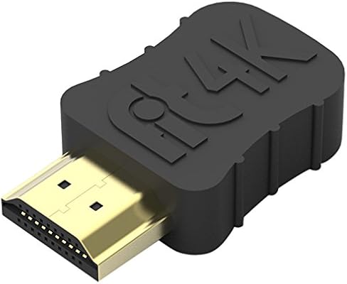

When accessing via VNC (“screen sharing”) that dongle makes the Mac think it has a high-res display connected. Without it it defaults to VGA or some low-res amount. I’ve been using one here for years on my headless Mac mini. I don’t see how it would help getting a directly corrected display to work.
