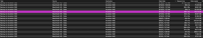

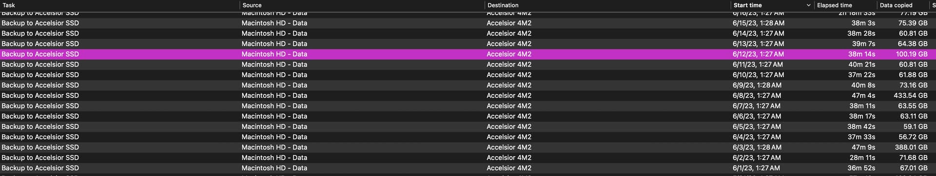

That said - this is a log of incremental backups currently from my 4M2 on my 2019 Mac Pro - which is advertised as “up to 2800 MB/S”. Whatever the units - this performance is similar to what is advertised for the new Mac Pro with Thunderbird. The 8M4 internal SSD is advertised as about 10 times faster.
It would take several hours to transfers 8TB on the current SSD. That’s not easy to do as I shut down Devonthink during the backup and there are not that many hours per day Devonthink is not being accessed by someone.
Something else is going on there. That’s only around 50 megabytes per second. It could be because it’s copying tons of small files, or another issue.
