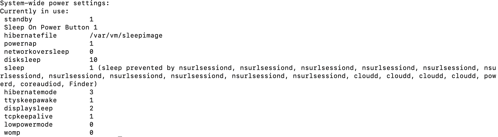

Thanks! and sorry for the late reply. This is what I got from the Terminal running the command:
System-wide power settings:
Currently in use:
standby 1
Sleep On Power Button 1
hibernatefile /var/vm/sleepimage
powernap 1
networkoversleep 0
disksleep 10
sleep 1 (sleep prevented by nsurlsessiond, nsurlsessiond, nsurlsessiond, nsurlsessiond, nsurlsessiond, nsurlsessiond, nsurlsessiond, nsurlsessiond, nsurlsessiond, nsurlsessiond, nsurlsessiond, cloudd, cloudd, cloudd, cloudd, powerd, coreaudiod, Finder)
hibernatemode 3
ttyskeepawake 1
displaysleep 2
tcpkeepalive 1
lowpowermode 0
womp 0
